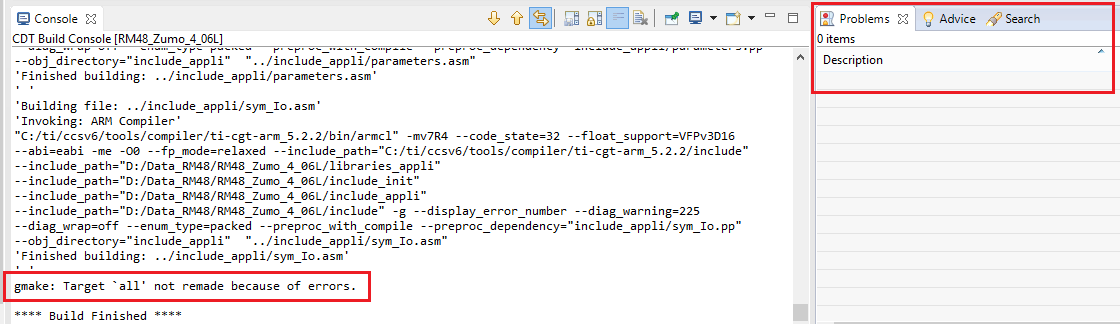

I got the following warning:
#10189-D archive symbol directory is missing from archive "../include_appli/assR18.lib"
If I replace in source file “.Include     assR18.asm” by “.Include     assR18.lib” There is no illegal mnemonic error and the compilation seems to be good except that the project is not remade because of error:
gmake: Target `all' not remade because of errors.
**** Build Finished ****
The compiler does not tell us anything about the error.

    "asstestTO.alib", ERROR!   at line 1: [E0003] Only labels and comments may begin in the first column. Make sure that the label name is not a reserved keyword.
    	!<arch>
    "asstestTO.alib", ERROR!   at line 1: [E0002] Illegal mnemonic specified
    	!<arch>
    "asstestTO.alib", ERROR!   at line 2: [E0002] Illegal mnemonic specified
    	taskTstTO/      1441785614  0     0     0       215       `
    "asstestTO.alib", ERROR!   at line 2: [E0000] Unrecognized special character
    Errors in Source - Assembler Aborted
    4 Assembly Errors, No Assembly Warnings
    >> Compilation failure
    gmake: *** [source_appli/subs_sound_R10.obj] Error 1
    Thanks for your help.
    Jerome
  • As indicated by the Assembly Language Tools user's guide, the macro must be in a file with the same name as the macro, and must have the file extension .asm. Rename your assembly file to taskTstTO.asm and rebuild the macro library
  • For some reason, the assembler is seeing asstestTO.alib as an input file, rather than a macro library as it should be. Make sure you are using .mlib and not .include to refer to asstestTO.alib
    All is OK now.
    Kind regards
