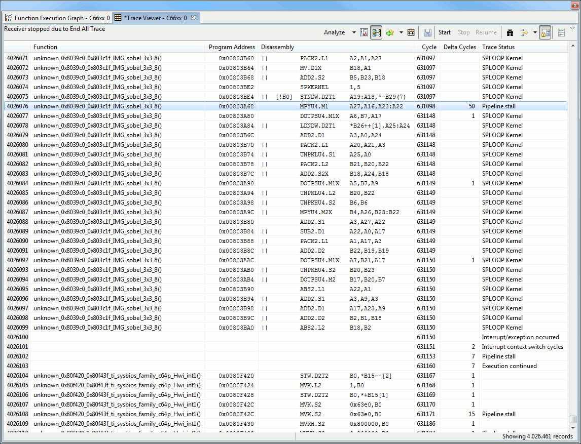

I think there exists a problem with certain SPLOOP code, which causes a 'Loop buffer exception' and 'Missed stall exception' when CCS tries to access the target. I already noticed this problem in the past with different optimized loops. I could avoid the problem by disabling SPLOOP for the affected files. But now I'm using a IMGLIB function which is causing the same problem (IMG_sobel_3x3_8()).

Thanks for sending the details and the test case. I was able to reproduce the exception, which also happens if I halt the code, do some Assembly single Steps and re-run it (check the attached clip) or even inspect a global variable on the Expressions view.
Your original description indicates the Debugger is influencing the runtime behavior, but with the Assembly steps I am not so sure anymore (the code should have executed without problems).
One workaround I found was to enable Real-Time Mode (check the attached clip). Just be sure to disable it before halting the core.
Thus, just like you, I am unsure where this issue is being originated but I will ask around.
Rafael

I was able to pinpoint the component that is faulty: the IMGLIB. I modified my CCSv5.5 project (that uses all the original components you mentioned) and switched this library in the project options - the error does not happen anymore.
I attach my project that has two build configurations: one for each IMGLIB version. To switch between them, simply right click on the project and select Build Configurations --> Set Active.
Please feel free to give this a try.
As for why the code was thrown off when accessing the target - I can only suspect that the IMG_sobel_3x3_8() function of the original version was not entirely safe while executing its main loop, thus the debug access disrupted its normal execution. Unfortunately I am not well versed in its internals and perhaps this was hand-optimized assembly..
