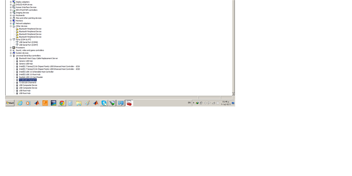

  • in the "Devices and Printers" tab of Control Panel it is Unspecified Device called "Texas Instruments XDS 100+Rs232 V1"
  • Can you check your Device Manager? If possible paste the screenshot of the same, it should look something like this:
  •  yes it looks like that
  • But did you change to XDS100v2 in target configuration in CCS v4? Also, please update to CCS v6.1 which is the latest and helping you would be much easier.
  • Although the device manager shows that XDS is specified correctly , in the "Devices and Printers" tab of Control Panel there is Unspecified Device called "Texas Instruments XDS 100+Rs232 V1"
