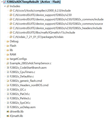

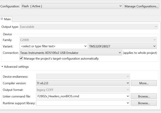

Hey Guys,
It seems that I am having linker issues.
I have this verified code as seen below:

Now whenever I try to compile it i get the following errors as seen here in the log file:
-l"C:/Users/Carlo/Documents/GIT_Controlled_Projects/falcon/CCS_WKspace/Example_F2802xAdcTempSensor/../../f2802x_common/cmd/F2802x_generic_flash.cmd" -l"rts2800_ml.lib" -l"IQmath.lib"
error: cannot find file
warning: creating output section ".cinit" without a SECTIONS specification
warning: creating output section ".ebss" without a SECTIONS specification
warning: creating output section ".econst" without a SECTIONS specification
warning: creating output section ".reset" without a SECTIONS specification
warning: creating output section ".text" without a SECTIONS specification
warning: creating output section "codestart" without a SECTIONS specification
warning: creating output section "ramfuncs" without a SECTIONS specification
error: no valid memory range(NULL) available for placement of ".text"
error: program will not fit into available memory. placement with
alignment/blocking fails for section ".text" size 0xcce page 0
alignment/blocking fails for section ".econst" size 0x200 page 0. Available
memory ranges:
alignment/blocking fails for section ".cinit" size 0xae page 0. Available
memory ranges:
error: program will not fit into available memory. run placement with
alignment/blocking fails for section ".ebss" size 0x9b page 1. Available
memory ranges:
DEV_EMU size: 0x105 unused: 0x1 max hole: 0x1
SYS_PWR_CTL size: 0x3 unused: 0x0 max hole: 0x0
FLASH_REGS size: 0x60 unused: 0x58 max hole: 0x58
CSM size: 0x10 unused: 0x0 max hole: 0x0
ADC_RESULT size: 0x20 unused: 0x0 max hole: 0x0
CPU_TIMER0 size: 0x8 unused: 0x0 max hole: 0x0
CPU_TIMER1 size: 0x8 unused: 0x0 max hole: 0x0
CPU_TIMER2 size: 0x8 unused: 0x0 max hole: 0x0
PIE_CTRL size: 0x20 unused: 0x6 max hole: 0x6
PIE_VECT size: 0x100 unused: 0x0 max hole: 0x0
COMP1 size: 0x20 unused: 0xf max hole: 0xf
COMP2 size: 0x20 unused: 0xf max hole: 0xf
EPWM1 size: 0x40 unused: 0x0 max hole: 0x0
EPWM2 size: 0x40 unused: 0x0 max hole: 0x0
EPWM3 size: 0x40 unused: 0x0 max hole: 0x0
EPWM4 size: 0x40 unused: 0x0 max hole: 0x0
ECAP1 size: 0x20 unused: 0x0 max hole: 0x0
GPIOCTRL size: 0x40 unused: 0x0 max hole: 0x0
GPIODAT size: 0x20 unused: 0x0 max hole: 0x0
GPIOINT size: 0x20 unused: 0x16 max hole: 0x16
SYSTEM size: 0x20 unused: 0x1 max hole: 0x1
SPIA size: 0x10 unused: 0x0 max hole: 0x0
SCIA size: 0x10 unused: 0x0 max hole: 0x0
NMIINTRUPT size: 0x10 unused: 0x0 max hole: 0x0
XINTRUPT size: 0x10 unused: 0x0 max hole: 0x0
ADC size: 0x80 unused: 0x2f max hole: 0x2f
I2CA size: 0x40 unused: 0x1e max hole: 0x1e
PARTID size: 0x1 unused: 0x0 max hole: 0x0
CSM_PWL size: 0x8 unused: 0x0 max hole: 0x0
alignment/blocking fails for section "ramfuncs" size 0x5a page 0. Available
memory ranges:
alignment/blocking fails for section ".reset" size 0x2 page 0. Available
memory ranges:
alignment/blocking fails for section "codestart" size 0x2 page 0. Available
memory ranges:
undefined first referenced
symbol in file
_RamfuncsLoadSize ./Example_2802xAdcTempSensor.obj
_RamfuncsLoadStart ./Example_2802xAdcTempSensor.obj
_RamfuncsRunStart ./Example_2802xAdcTempSensor.obj
error: unresolved symbols remain
error: errors encountered during linking; "Example_F2802xAdcTempSensor.out" not
built
>> Compilation failure
gmake: *** [Example_F2802xAdcTempSensor.out] Error 1
gmake: Target `all' not remade because of errors.
**** Build Finished ****
I am using a C2000 TMS320F28027 chip so I know that the code above is not maxing out the memory, thus the problem has to be in the linker.
Here is my current CCS General setup is as seen below:
I have tried everything to fix this problem, however so  far no progress.
Any and all help is appreciated.
Thank you in advance,
Carlo

    Focus on this error. The linker is not able to find that file in that path. The f2802x_common directory is in ControlSuite so unless you copied over the entire contents of the f2802x directory from ControlSuite to your workspace, this path should point to the correct file within ControlSuite.
    You can find this setting under Project Properties->Build->Linker->File Search Path.
  • Hey AartiG,
    So I went ahead and pointed the linker in the right direction however now I'm getting the error below:

    However I have not touched the flash file.This code is already verified to run however I'm not truly sure as to why it is not building. I have gotten it to build on my other computer so I know that it will fit and that everything should work fine.
    Carlo
  • My first suggestion would be to import the example project Example_2802xAdcTempSensor as-is from ControlSuite, and study the structure and files that are part of the project, specifically the linker command files (.cmd). You should see two linker command files in the project - F2802x_generic_ram.cmd and F2802x_Headers_nonBIOS.cmd. Both these files are required for a successful build, and each should only be specified once in the link command.
    It appears that you are using F2802x_generic_flash.cmd instead of F2802x_generic_ram.cmd, and that is ok as long as you have taken the necessary steps to allow the program to run from flash. But pay close attention to the linker command that you see in the CCS build console. Yours looks like this:
    "C:/ti/ccsv5/tools/compiler/c2000_6.2.0/bin/cl2000" -v28 -ml -mt -Ooff -g --define="_DEBUG" --define="_FLASH" --define="LARGE_MODEL" --quiet --verbose_diagnostics --diag_warning=225 --diag_suppress=232 --diag_suppress=10063 --output_all_syms --cdebug_asm_data -z -m"Example_F2802xAdcTempSensor.map" --stack_size=0x100 --warn_sections -i"C:/ti/ccsv5/tools/compiler/c2000_6.2.0/lib" -i"C:/ti/ccsv5/tools/compiler/c2000_6.2.0/include" -i"C:/Users/Carlo/Documents/GIT_Controlled_Projects/falcon/CCS_WKspace/F2802xADCTempRebuilt" -i"C:/Users/Carlo/Documents/GIT_Controlled_Projects/falcon/f2802x_common/lib" -i"C:/Users/Carlo/libs/math/IQmath/v15c/lib" --reread_libs --verbose_diagnostics --issue_remarks --xml_link_info="Example_F2802xAdcTempSensor_linkInfo.xml" --entry_point=code_start --rom_model -o "Example_F2802xAdcTempSensor.out"  "../Debug/F2802x_usDelay.obj" "../Debug/F2802x_SysCtrl.obj" "../Debug/F2802x_PieVect.obj" "../Debug/F2802x_PieCtrl.obj" "../Debug/F2802x_I2C.obj" "../Debug/F2802x_DefaultIsr.obj" "../Debug/F2802x_CpuTimers.obj" "../Debug/F2802x_CodeStartBranch.obj" "../Debug/Example_2802xAdcTempSensor.obj" "./F2802x_usDelay.obj" "./F2802x_SysCtrl.obj" "./F2802x_PieVect.obj" "./F2802x_PieCtrl.obj" "./F2802x_I2C.obj" "./F2802x_DefaultIsr.obj" "./F2802x_CpuTimers.obj" "./F2802x_CodeStartBranch.obj" "./Example_2802xAdcTempSensor.obj" "../F2802x_Headers_nonBIOS.cmd" "../F2802x_generic_flash.cmd" "../IQmath.lib" "../driverlib.lib" "../lib/IQmath.lib" "../lib/driverlib.lib" -l"C:\ti\controlSUITE\device_support\f2802x\v230\f2802x_common\cmd\F2802x_generic_flash.cmd" -l"rts2800_ml.lib" -l"IQmath.lib"
    Notice how F2802x_generic_flash.cmd is passed twice to the linker. It should only be passed once, either as part of the project (with the file added or linked to the project) or via the -l linker option. Please remove one or the other and rebuild.
  • ArtiG,
    I went ahead and removed the flash.cmd file from the linker and left it in the work-space as seen here:
    Now after I did that I refreshed, cleaned, and rebuilt the project and came up with these errors:

    I tried to fix this by linking it to the global variable define as i saw this issue resolved in other e2e posts however, the GlobalVariableDefine file does not exist within the f2802x file. I did notice that this file was usually located within the source folder so i went ahead and tried linking the compiler and the linker to the source folder however both attempts were unsuccessful, thus i am left the errors seen above.
  • Carlo Bocatto said:
    'Building target: Example_F2802xAdcTempSensor.out' 'Invoking: C2000 Linker' "C:/ti/ccsv5/tools/compiler/c2000_6.2.0/bin/cl2000" -v28 -ml -mt -Ooff -g --define="_DEBUG" --define="_FLASH" --define="LARGE_MODEL" --quiet --verbose_diagnostics --diag_warning=225 --diag_suppress=232 --diag_suppress=10063 --output_all_syms --cdebug_asm_data -z -m"Example_F2802xAdcTempSensor.map" --stack_size=0x100 --warn_sections -i"C:/ti/ccsv5/tools/compiler/c2000_6.2.0/lib" -i"C:/ti/ccsv5/tools/compiler/c2000_6.2.0/include" -i"C:/Users/Carlo/Documents/GIT_Controlled_Projects/falcon/CCS_WKspace/F2802xADCTempRebuilt" -i"C:/Users/Carlo/Documents/GIT_Controlled_Projects/falcon/f2802x_common/lib" -i"C:/Users/Carlo/libs/math/IQmath/v15c/lib" --reread_libs --verbose_diagnostics --issue_remarks --xml_link_info="Example_F2802xAdcTempSensor_linkInfo.xml" --entry_point=code_start --rom_model -o "Example_F2802xAdcTempSensor.out" "../Debug/F2802x_usDelay.obj" "../Debug/F2802x_SysCtrl.obj" "../Debug/F2802x_PieVect.obj" "../Debug/F2802x_PieCtrl.obj" "../Debug/F2802x_I2C.obj" "../Debug/F2802x_DefaultIsr.obj" "../Debug/F2802x_CpuTimers.obj" "../Debug/F2802x_CodeStartBranch.obj" "../Debug/Example_2802xAdcTempSensor.obj" "./F2802x_usDelay.obj" "./F2802x_SysCtrl.obj" "./F2802x_PieVect.obj" "./F2802x_PieCtrl.obj" "./F2802x_I2C.obj" "./F2802x_DefaultIsr.obj" "./F2802x_CpuTimers.obj" "./F2802x_CodeStartBranch.obj" "./Example_2802xAdcTempSensor.obj" "../F2802x_Headers_nonBIOS.cmd" "../F2802x_generic_flash.cmd" "../IQmath.lib" "../driverlib.lib" "../lib/IQmath.lib" "../lib/driverlib.lib" -l"rts2800_ml.lib" -l"IQmath.lib"
    From this command, I see that all the .obj files are being passed twice to the linker, one from the current build configuration and one from the /Debug subdirectory. The same thing is happening for IQmath.lib and driverlib.lib - they are coming from two different places. I don't know how this happened for your project but that is the reason for the "symbol redefined" errors.
    As I suggested earlier, the best course of action would be to import the example project Example_2802xAdcTempSensor as-is from ControlSuite (without any modifications) and take a look at the files that are part of the project and understand how they fit in in the build process. There is a lot of good information about the project and build system and the most common files in a CCS project in this wiki:
    http://processors.wiki.ti.com/index.php/Projects_and_Build_Handbook_for_CCS
  • I went ahead and got it working! I am not sure what happened during the transfer however, I was able to get it working by copying and pasting the working project into my new work space and then re-linking the necessary files. Thank you, for your help ArtiG!!!!
    -Carlo
