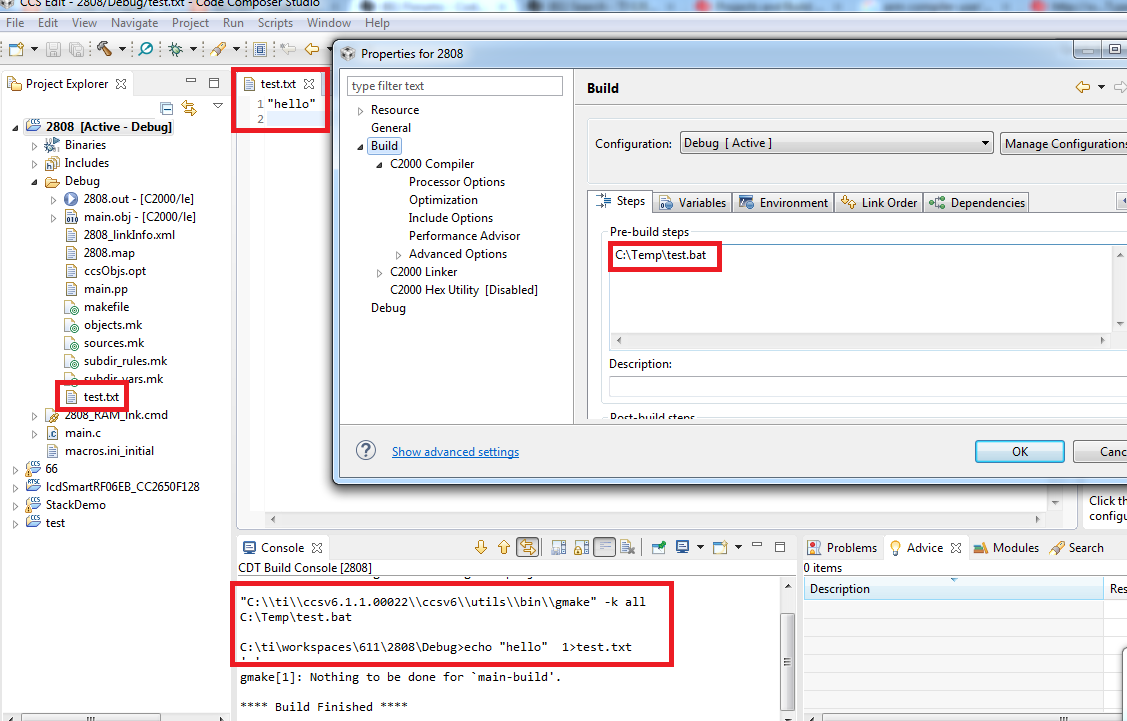

    I have two issues that I'm sure are simple mistakes - are there any pages that give examples of setting up the pre build steps and cmd files? Is a cmd file a linker command file or is the linker file a subtype of the command file?
    I tried included in batch file which is simply:
    echo "hello" > test.txt
    which runs when executed from the command line but when CCS runs it I just get the output in the console and no new file produced:
    ..workspace\project\Debug - project>echo "hello"  1>test.txt

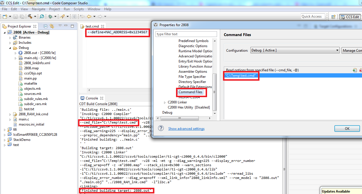

    I tried just adding a static cmd file with:
    --define=MAC_ADDRESS=0x1234567
    but I get an undefined error on build.
    This worked for me. Check the project configuration subfolder:
    This also worked for me (no errors, MAC_ADDRESS is used the the source and build was successful):
