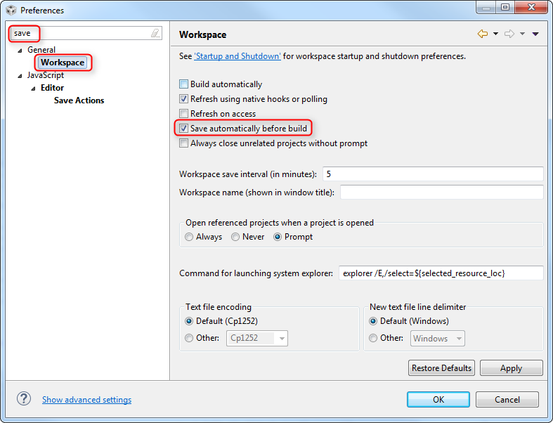

    CCS should save automatically prior to a build (in this case a build happens if needed when you click debug).  Can you check if the option is set.
    Go to Window -> Preferences
    Type save in the filter box at the top left.  Then check the option as shown below

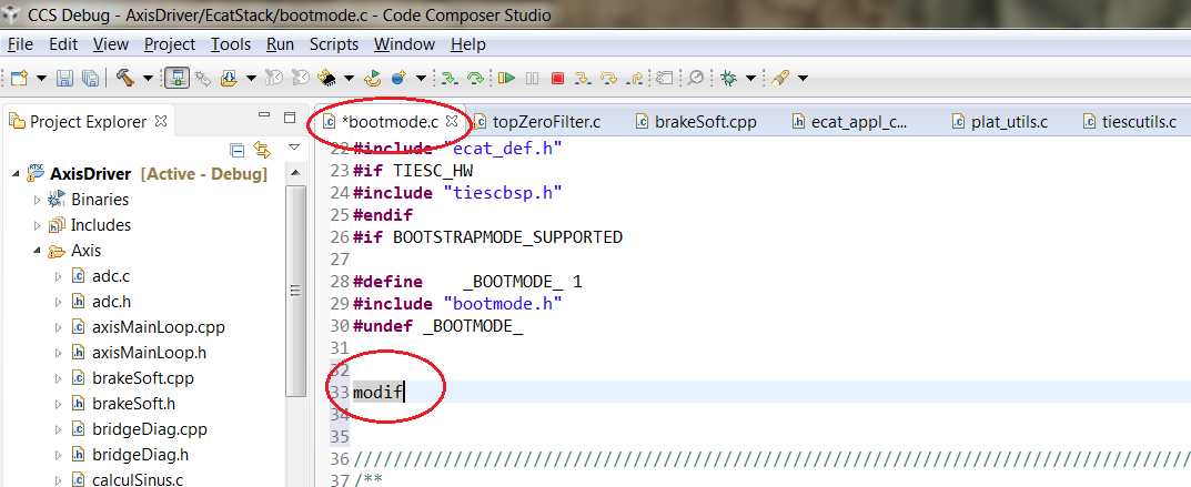

    If that box is already checked can you take a capture of that file in the project explorer?  I want to see what the icon looks like.  Do you get the same behavior if you edit bootmode.c?

    In the preference/Save window the options was correctly set as you recommended it.

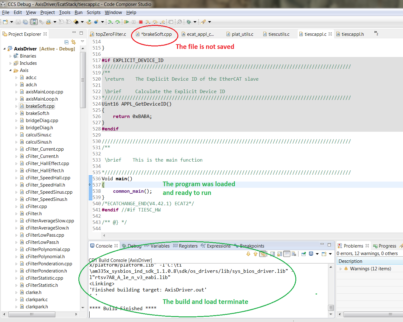

    Below, the capture of the workspace before and after the build/load:

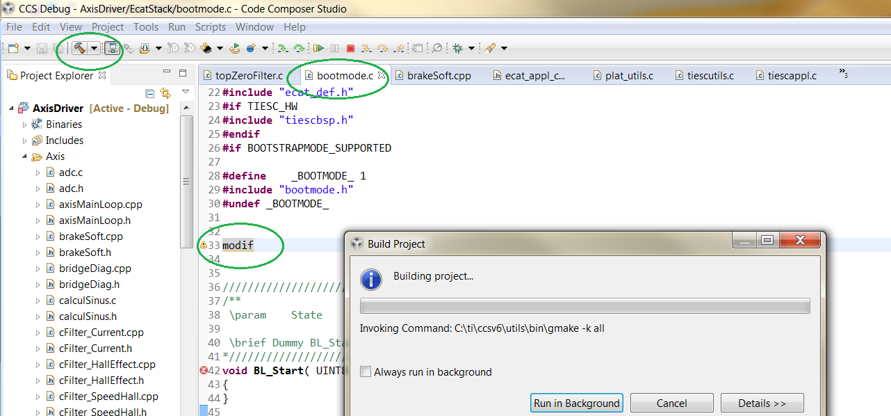

    Same behaviour with the bootmode.c file:
    An observation: If I build with the Build button, it's ok.

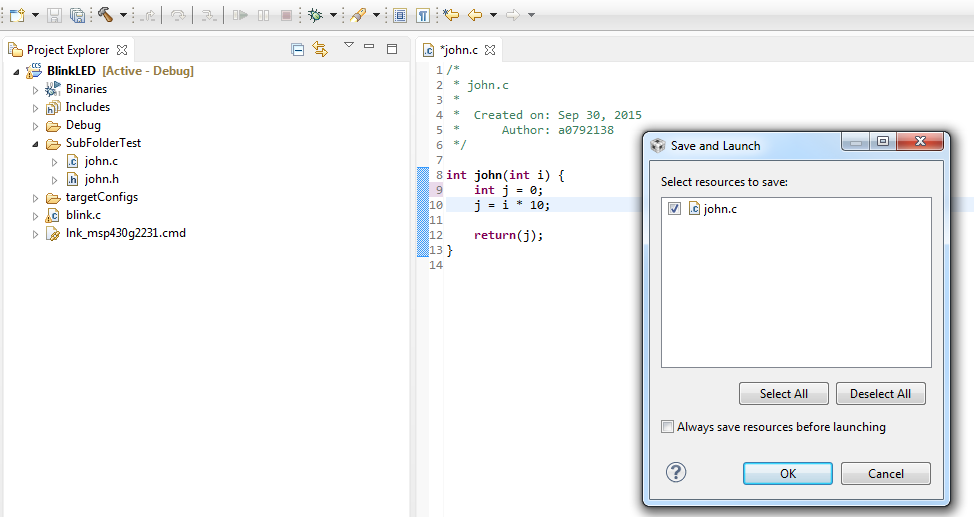

  • I was wondering if it was an issue with the file being in a subfolder.  But I created a project with a subfolder and could not reproduce.
    For me when I click the build button it automatically saves the changes.  If I click the bug button I get a dialog prompting me to save:
    I am going to search around to see if I can find any other settings that may be causing the differences between what you and I see.
    John

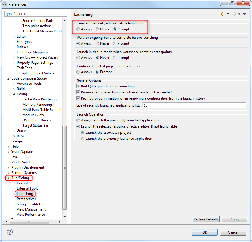

  • I believe I found the setting.  If I change the setting below to Never then I see the same that you do.  With it as prompt I see the dialog that I see and if I change to always then it just saves without asking me.
