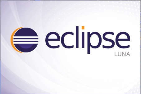

Hi AartiG
Removing 256M line from ccstudio.ini changed the initial box background image to:
But, CCS opens and I can edit and compile.

Sergio Kamakura said:Removing 256M line from ccstudio.ini changed the initial box background image to:
I had hit a similar issue with the "failed to create Java virtual machine" once with my CCS 6.1.0 and Windows 7. At that time, I removed the 256M line from ccstudio.ini and saw the same Eclipse splash screen as you mentioned. At a later time, I reverted the ccstudio.ini back to the original one, and then was able to get back not only the CCS splash screen, but did not experience the "failed to create Java virtual machine" message again either. My current ccstudio.ini has 256M and also -Xms40m and -Xmx512m and it is working well again.
