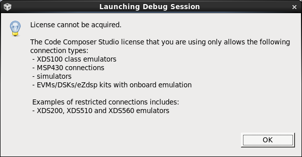

I believe I have been able to get everything setup correctly to use a Segger J-Link with Code Composer Studio. I am attempting to work with a CC2650 target.
Right now, I am attempting to use an unlicensed version of CCS. Do I need a licensed version to use a Segger? It does give me a message that a license cannot be acquired, but it is not clear to me why I would need a license.
    With CCS 6.1.1 confirm that a license is required to use a Segger J-Link. If I debug using Segger J-Link with a full license can debug OK. If I try and debug using Segger J-Link with a free license the program is downloaded and stops at main, but after a few seconds I get the following, and the debugging session is terminated when click OK:

  • And as Chester already mentioned, you need a full license to use J-link with CCS
