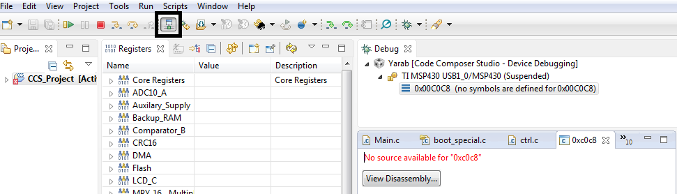

    I made another debug profile , and i changed the USB port to be USB port1<default>, although the USB is not USB 1, it is actually Port 2,
    So now i successfully connected to the target and i can debug , but i have another problem.
    The problem is as follow:
    1- When i pressed the debug button, the code does not go to the main ( start point), i have to follow these steps to can start from main
    So is thier any way to let the debuger start to point the main directly.
    You probably clicked the Debug button with the Target Configuration file open in the Target Configuration editor and in focus. This is a way to manually launch the debugger.
    To perform those steps automatically, make sure the project is in focus when clicking the Debug button.
    See this wiki for more details: http://processors.wiki.ti.com/index.php/Debug_Handbook_for_CCS#Launching_Debugger
