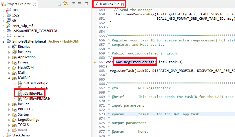

    Those missing symbols should be defined in the source files that are part of the project. For example:
    user3887813 said:
    unresolved symbol GAP_RegisterForMsgs, first referenced in <whole-program>    SimpleBLEPeripheralStack             C/C++ Problem
    GAP_RegisterForMsgs is defined in ICallBleAPI.c. It should be part of your project:
    Check to make sure that all the necessary files are part of the project. Since all these files are links, check for broken links.

  • Hi ki,
    I check the relevant file, i think  all relevant files are included. so i don't know where i  have missed. But i observed you refer the project is different with me.

  • Ah ok, you are building the stack. Sorry.
    Can you post the full linker output? It should look something like:
