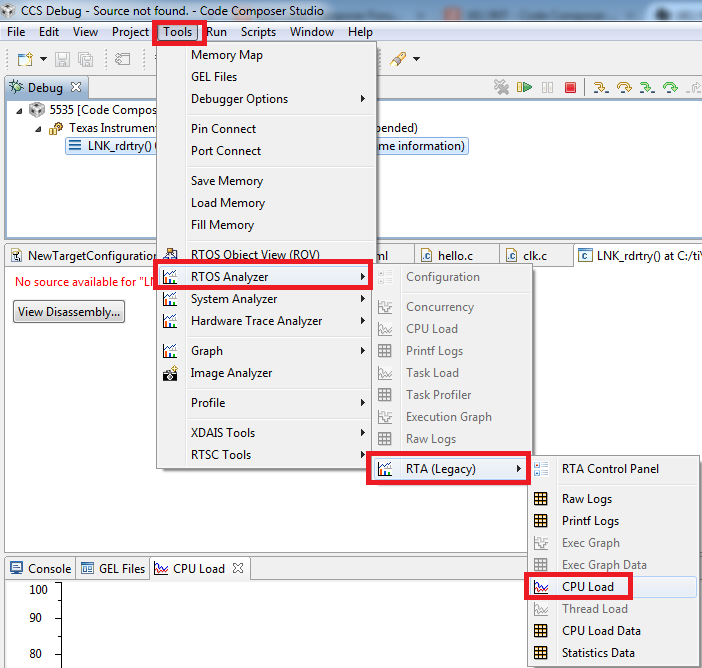

Hi Guys,
I am new here. I am trying to use CCS to get the RTA to give me CPU load graph and/or CPU load values. Unfortunately every time I get RTA greyed out. I am using CCS 5.2.
Maybe if U can point me about
a) what is the latest version of CCS and DSP/BIOS that I should be using
b) any tricks in getting RTA to show the different options.
c) Any other tips/hints for debugging.
Appreciate any help.
Sam

  • Hi Sam,
    1) I'd recommend you update to the latest CCSv5 version - CCSv5.5. It comes with DSP/BIOS 5.42.01.09
    2) Note that the DSP/BIOS RTA features are under:
    3) Check out the v5 Training page:

  • Can you try using one of the default BIOS examples for your board? The RTA Legacy menu options are not dictated by the tcf file so I'm not sure why hacking a tcf file would have any impact.
    I'm sorry for your bad experiences with CCS. CCSv5.5 is likely your best bet since I believe CCSv6 has dropped legacy RTA support for C5x.
    Also what is the history of your current project? Was it originally created with CCSv5.2
