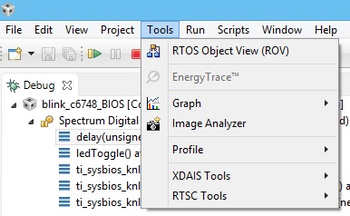

CCS 6.1.1 Tools->RTOS Analyzer menu is gone.
I am using CCS v6.1.1 and was going through the lab #4 for the TI RTOS Kernel Workshop.
I am using TI-RTOS for c6000 v2.0.1.23,
XDCtools v 3.31.0.24_core
CCS 6.1.1 does not even have the a menu item for Tools->RTOS Analyzer.
Do I have the wrong combination of versions?  Which do I need to complete Lab 4?
I am trying to get to the Execution Analysis Graph.
My setup is.
    This menu is populated irrespective of the installed RTSC version, therefore can you check the sections General IDE and Debugger of the page below?
    processors.wiki.ti.com/.../Troubleshooting_CCSv6
    If that does not help, I am afraid something corrupted your installation of CCS - more specifically the plugin that controls this menu. Being an intrinsic component of CCS, there is no possibility of reinstalling just this component and therefore I am afraid a reinstall will have to be performed.
    I apologize for the inconvenience,
    Rafael
  • It turns out that a power cycle of my computer did the trick and brought back the menu item. I am not sure what set of action got into this buggy condition, but a power cycle fixed it.
