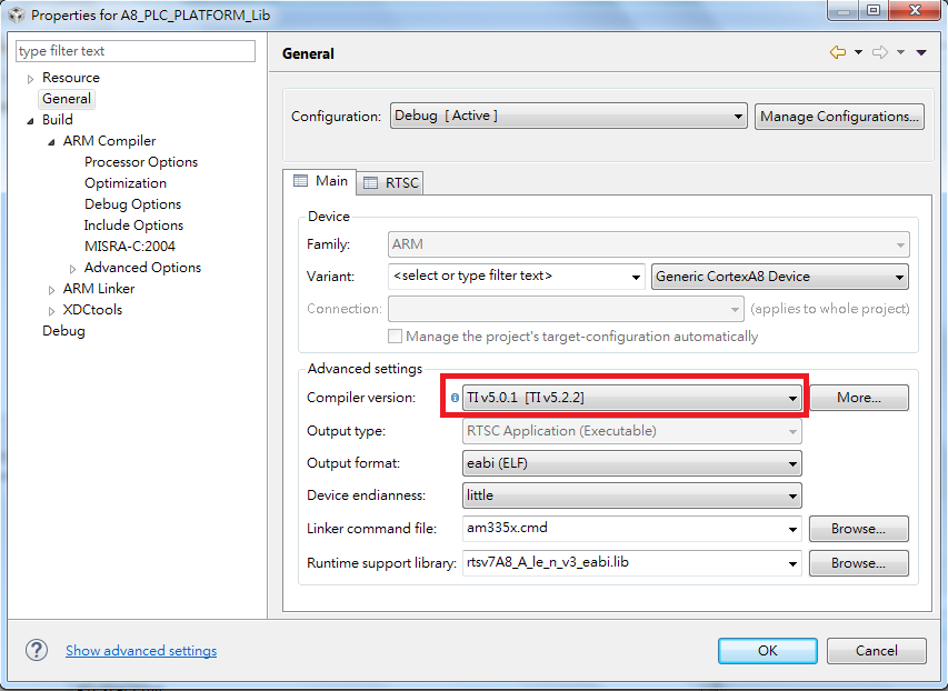

  • Hi Sir :
    As you can see the picture below, there is an exclamation mark near compiler version.
    So, maybe it can confirm that my third party's project is compiled by version V 5.0.1, but CCS V6 only have version V 5.2.2.
    Therefor, in CCS V6, the project is compiled by V 5.2.2, am I right?
    If what I think is correct, should I install old version of compiler?
    If the answer is yes, where can I find old version of compiler?
    Marcus
    Yes, you are correct
    Usually it is best to simply user the newer version of the compiler, unless recommended otherwise. But if you run into problems with the newer version, you can switch to the older.
    See: http://processors.wiki.ti.com/index.php/Compiler_Updates#Installing_Older_Versions
