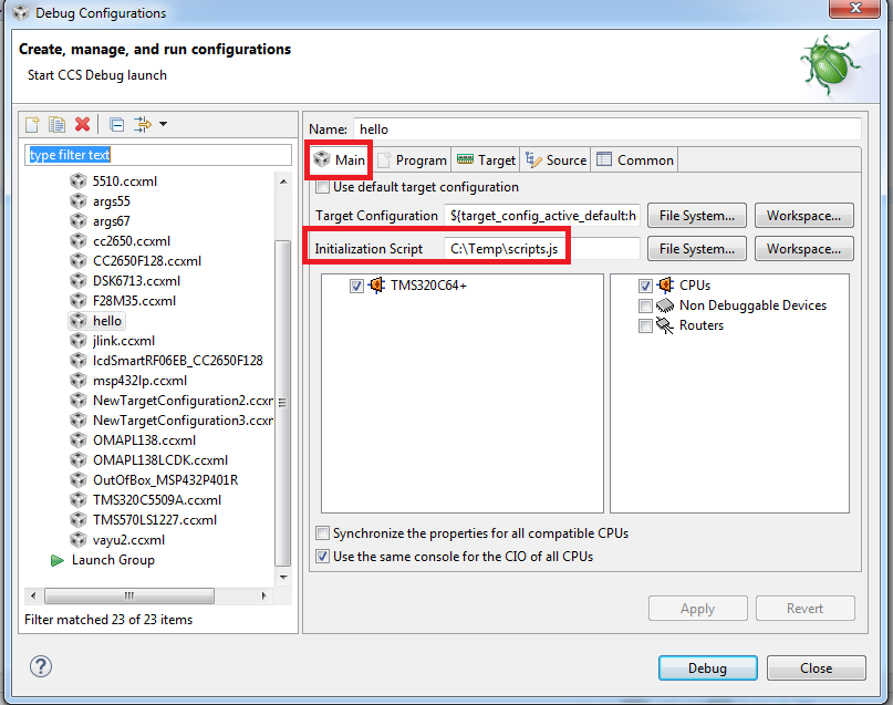

    You can specify your js file in the Initialization Script field for the associated debug configuration:

    About your second answer, If I use the initialization script, I can add some parameters. Could you tell me where I can found all specific variables from a project , for example we can see in your figure that ${target_config_active_default:... } is one of the variable, maybe it exists a variable for the program name too ?
    The initialization script field is quite limited in the types of variables it can accept. Basically it is not possible to make that path relative.
