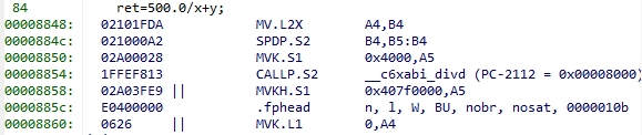

    After more test,  it seems that the rules that compiler call divd or divf for caculation  500.0/float is random, please see below test.
    call divf:
    call divd:
    Customer would like to know the rules and would you have some comments on this?
    -Thomas
    As I tried to explain previously, the constant 500.0 is explicitly a double-precision constant, and so I would expect a standard conforming C compiler to use a double precision division for 500.0/float.
    For the compiler to use single precision calculations the constants should be explicitly single precision, by adding a "f" suffix to the constants.

    The --keep_asm option was used to save the generated assembler. The generated code for the functions shows the following, with my understanding of what is expected:
    implicit_double_test_a : Uses __c6xabi_divf. Expected __c6xabi_divd to be used as a double precision constant is used
    implicit_double_test_b : Uses __c6xabi_divd, which is the expected result
    explicit_single_test_a : Uses __c6xabi_divf, which is the expected result
    explicit_single_test_b : Uses __c6xabi_divf, which is the expected result
    The CCS 6.1.1 project used is attached TMS320C6657_floating_point_divide.zip. The Debug\main.asm and Relase\main.asm contain the generated assembler, using the default CCS debug (no optimization) and release (optimization level 3) settings.

  • Markus Moll said:
    As I said, I believe the compiler is clever here. It sees that __c6xabi_divf(500.0f, x) produces exactly the same result as (float)__c6xabi_divd(500.0, (double)x), which it "should" compute. As the former is cheaper, it chooses to do all operations in single precision (unless the results differ, in which case it really is a compiler bug).
    By changing the constants I see what you mean. If I change the test program from using 500.0 / 500.0f to 500.1 / 500.1f then:
    - Both implicit_double_test_a() and implicit_double_test_b() call __c6xabi_divd
    - Both explicit_single_test_a() and explicit_single_test_b() call __c6xabi_divf
    Hopefully this answers the original question about how to ensure the compiler calls __c6xabi_divf rather than __c6xabi_divd
  • Markus and Chester are correct here. An unsuffixed float constant is a double, so the expression must be computed as a double. However, the compiler will optimize double expressions to float when it can show that the result will be the same; typically this is due to an assignment to a variable of type float.
