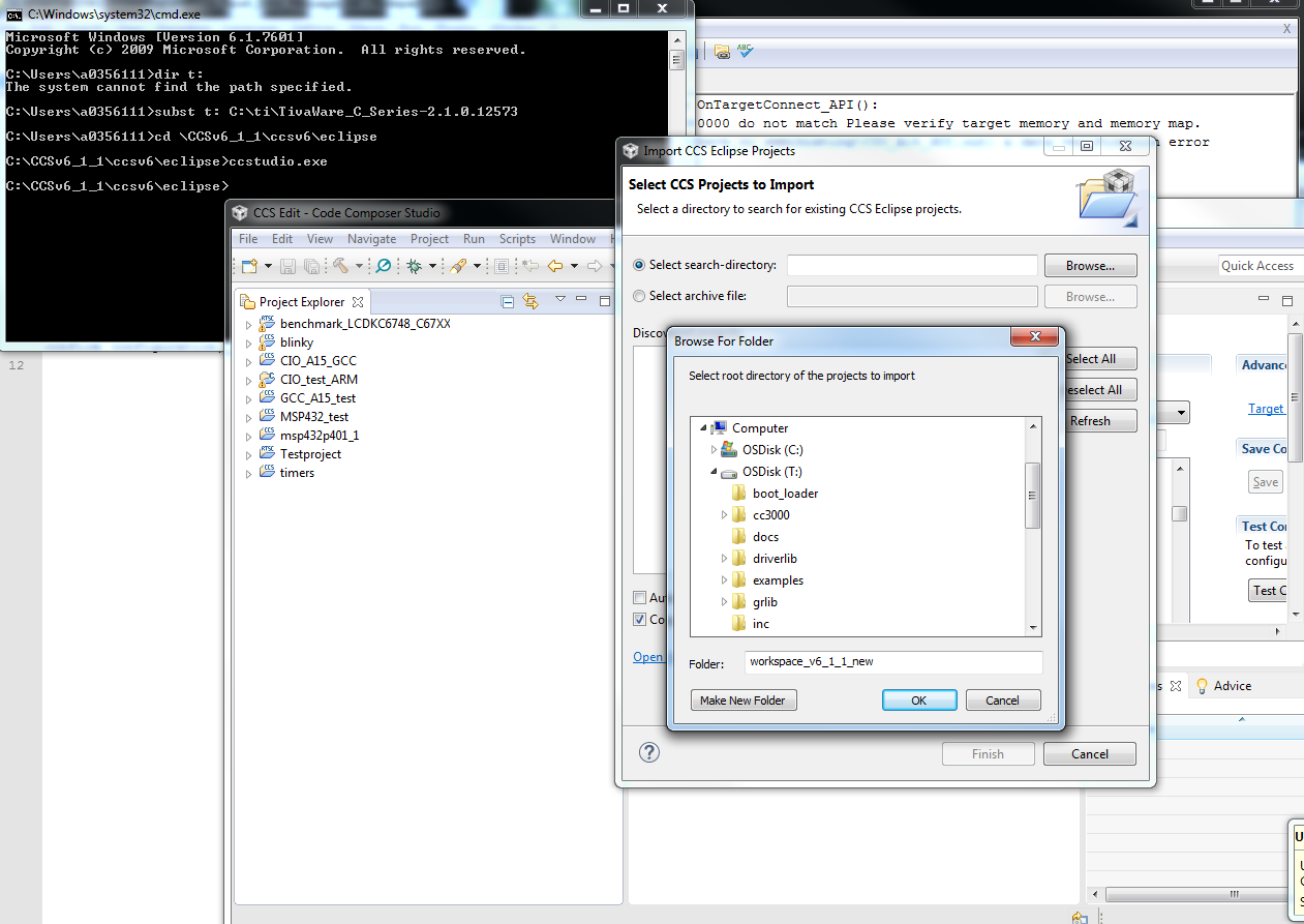

  • Tamas,
    I was able to properly recognize the subst drive on my CCSv6.1.1.00022.
    In order to do so, I issued the subst command and from the same cmd prompt I started CCS. Check the screenshot below.
    I am running the same OS as you.
    Perhaps if you can think of any additional details that you are doing differently, perhaps I could try to do the same here.
    Rafael
