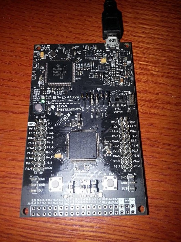

    You connection should look like this:
    Pibe said:
    I am running the latest CCS 6 version 6.1.1.00022 on a Linux host (Kubuntu 15.10). I have tried re-running the installer, running manually the emupack installer (6.0.14.5), re-running the install_scripts script, and cleaning the workspace. I tried connecting to a USB 2.0 and USB 3.0 port.
    I was able to connect using 6.1.1.00022 on Ubuntu 12.04-64. My setup looked like the picture above and I was plugged in a USB 2.0 port. Did you install CCS as 'user' and then ran the scripts as 'sudo'? Are you running as 'user' now?

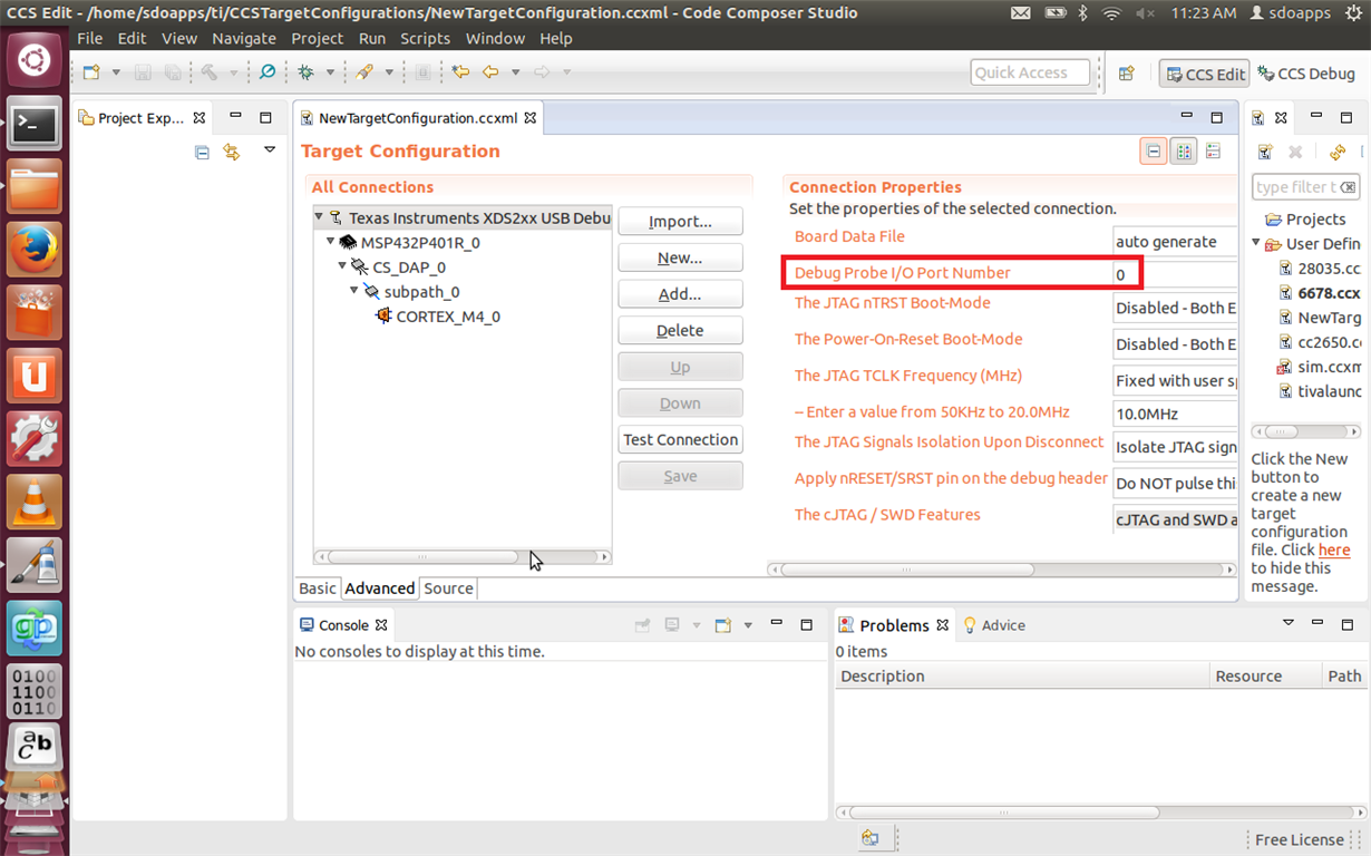

    Thank you Ki for looking into this. My question still remains: how do I tell CCS to connect to a probe with index 1 instead of 0?

  • Wait a minute. I have just noticed in the photo that you left all the jumpers connected. I disconnected all (to separate completely the on-board XDS adapter). Was the photo just to show the position of the cable or you are indicating the jumpers must be left on?
    BTW, I tried also leaving on just the 3.3V jumper and feed the power though the USB connector.
    It should always default to '0' unless you have some other device plugged in that is taking that spot. Is there any other devices plugged in that may be?
    In the mean time, change your target configuration to use io port 1 instead of 0
  • Oh, that's were it is! I did not follow the tree up. Thanks a lot, as soon as I get to the office I'll let you know how it went.
    yes, that was only to show the cable position. When you have the JTAG switch to use the external JTAG, the jumpers should not matter.
    I have an older (beta) board so some things may look different (like the switch too). But I also tried with a release version with the same (positive) results.

  • Thank you for letting me know how to change the index. That fixed the problem of CCS not seeing the probe.  Still, there is an error that seems to involve the Launchpad itself.  This is the (partial) output from "Test Connection":

  • You should not have to lower TCLK. I was able to connect without having to do anything extra.
    Here is a picture of the the release board that I am able to connect to, using my XDS200. I took the emulator off to make it easier to see the jumper settings:
  • Also, can you try starting a project-less debug session and see if you can connect that way?
  • That was it. In the most recent attempts I was using J6 to connect to a power supply, not the USB connector. I thought you could use J6 as a power connector too.
