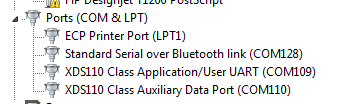

When I connect the sensortagDevPack, it doesn't appear in the Driver Manager
    By that you mean you don't see the entries below?
    If so, I would suspect the USB cable, the port or the DevPack itself are faulty. You can try to re-connect to different USB ports or change the cable.
    Also, do you see a green LED lit on your devpack? That could be another indicative of a faulty board.
    Rafael
  • Hi Rafael,
    Yes I don't see the entries.
    I tried several USB cables and different USB ports. Still nothing
    I can see the green LED lit on the devpack. So it most probably faulty board?
