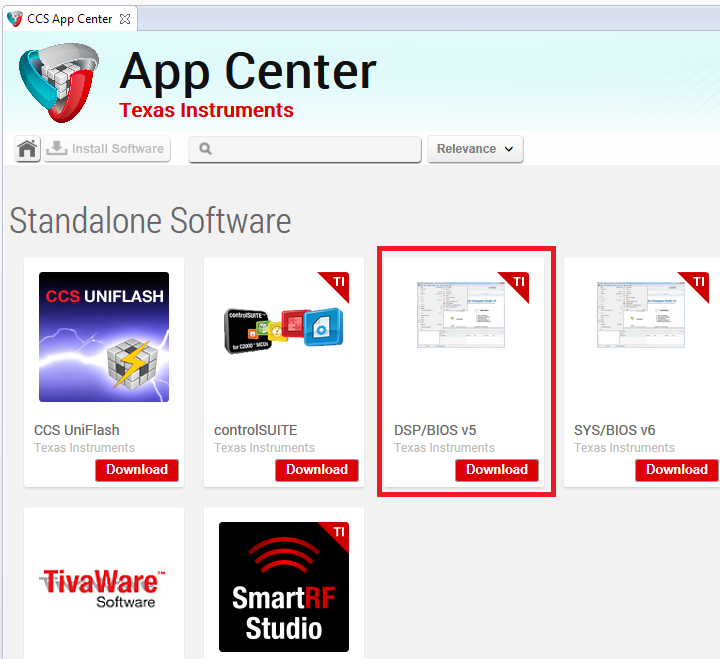

  • I will look into this. We can continue using the 7.4 compilers (I think we are a bit behind on these too. I was considering an upgrade.) Can we continue using the DSP/BIOS 5.42.0.7 or equivalent? I could not see a download for this for CCS 6, only DSP/BIOS 5.42.01.09 for 5.4. I've not understood the API change too, can we continue with coffabi if we wanted?
  • yes you can use the 7.4 compiler, COFF, and BIOS 5.4 with CCSv6. You can access the download link for BIOS 5 from App Center:
