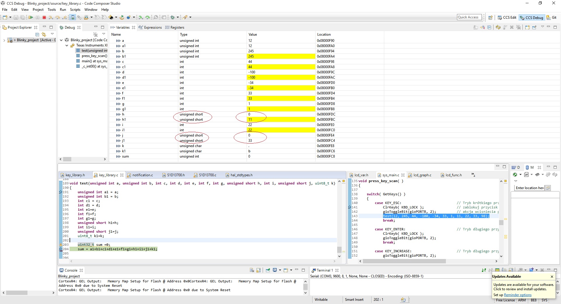

  • Hi everyone,
    I checked that variable is allocated in memory space but problem is with interpret it during reading. Short int is allocated on 32bit word like uint32. So this is the problem, variable type is interpreted incorrectly. I attached screenshot. On top is variables view. On right is function, and on left function call.

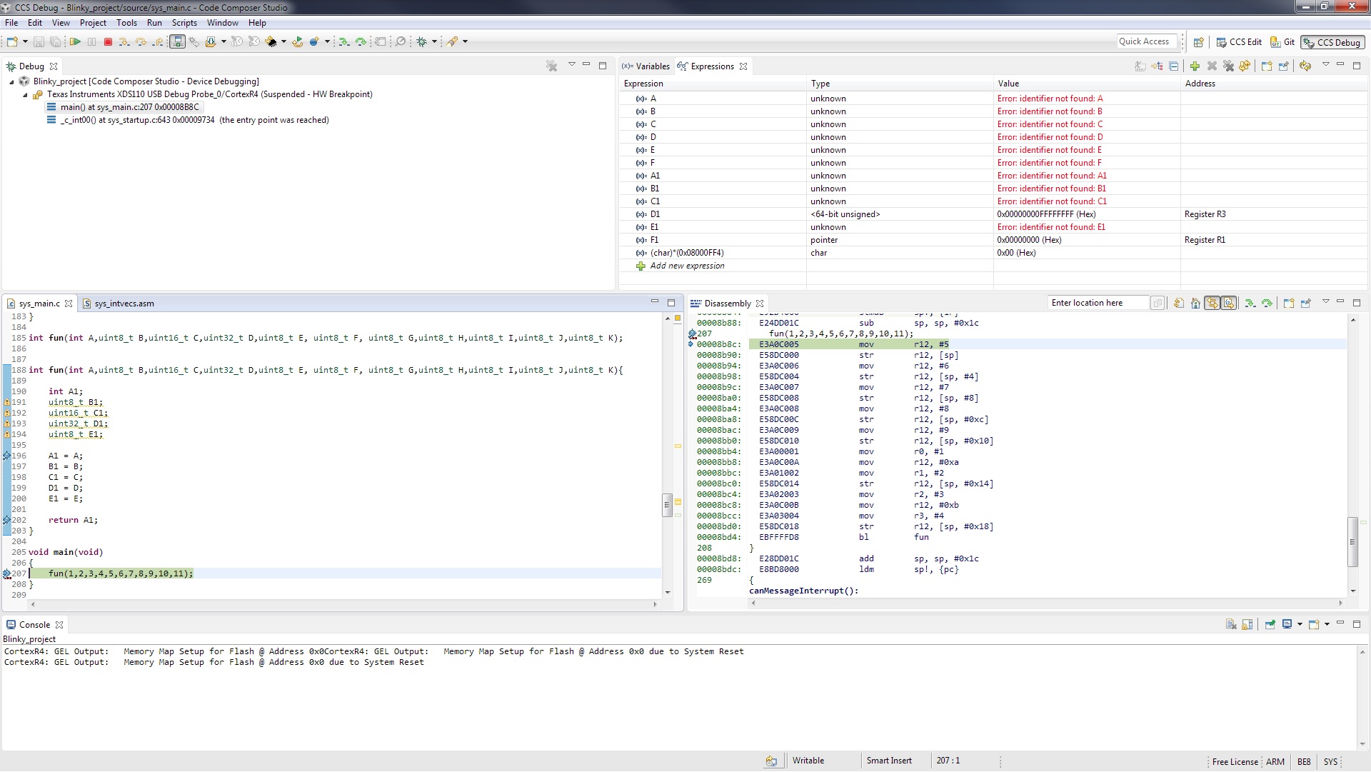

  • Helo,
    For a clearer explanation attached next screen. Look for function call and variables after execution.
    Reading variable "unsigned char F" returns 0x00 -> but in memory stack(0x08000FF4) is 0x00000006.
    When in expressions I put: (char)*(0x08000FF4) it return properly value:0x06. ..... I don't know what is wrong ... I seem to me like a problem with endianess or another problem with the interpretation of the data from the stack. By red circle I selected variable "F" and its stack position.
    Anoher news: this problem occures for more than 4 variables passed in the function.

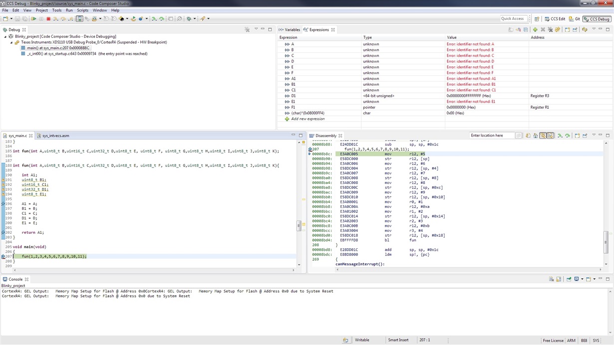

  • New fact: below is listening from diassebmly. Through registers [r0 - r3] variables are correctly put on stack. Next variables, all over the fourth are through by r12.
    Regardless of the type of the variable, r12 it  always a 32-bit word. [ r12, (sp #4) ] ...

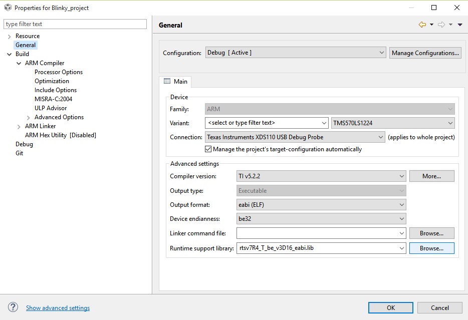

  • Hi, below compiler settings and sys_main.ppsys_main.rar
  • While I am not certain, I suspect this is not a compiler problem, but a problem in how CCS displays arguments that are passed on the stack and are smaller than int.  What makes you think this is a problem with the compiler?
    You showed some of the compiler settings, but not all of them.  When you build the project, the compiler executable armcl is invoked on each source file.  This appears in the Console window.  Please copy-n-paste the armcl command string for one source file (not everything) into a temporary text file.  Attach that text file to your next post.

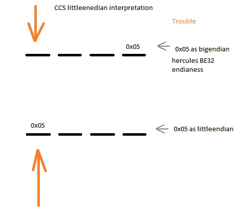

    armcl is included. Now I know that this isn't problem with compiler but with development environment (CCS). Variables are stored on stack as bigendian, but CCS reads them as littleendian. This issue occures when more than 4 vaiabled passed on stack (via r12) and smaller than int. Maybe it is possible to change interpretation method in CCS to be32 ?
    "C:/ti/ccsv6/tools/compiler/ti-cgt-arm_5.2.2/bin/armcl" -mv7R4 --code_state=32 --float_support=VFPv3D16 --abi=eabi -Ooff --include_path="C:/Users/Marcin/git/SPKRM1/include"
