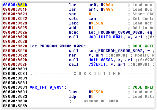

  • Hmm, I guess I misunderstood what the dsphex tool was doing, because this is really a binary file, not a text file with long strings of digits. It's really made to be written to memory directly. Here's a snapshot taken from IDA. I can't post the entire file due to disclosure agreements. But the screenshot shows the first few words of the file. For example at 0x2A you can see E388 8024 7A89 8031 7A89 8047, so
    BCND 802A
    CALL 8031
    CALL 8047

    Usually binary image files are a verbatim snapshot of the memory; no interpretation is performed. This image is meant to be loaded to a specific address, which is not specified in the file. In this scenario, the initial 0x8000 probably doesn't mean anything to the loader. The trick then is to figure out what the correct starting address is, and everything else should just fall into place.
    I doubt that F001 is meant to be treated as code, because it decodes as BCNDD #8002, !Carry, !BIO, which is a pretty weird instruction, especially for startup code. The first several words before 8002 are probably just a data table. 8002 as "SAR ar0, 0FF82h" is plausible, but BE41 as "bd 0BE41h, *br0+, ar5" is weird because br0+ is bit-reversed addressing, normally only used with algorithms like FFT. I'd guess that it, too, is part of data. Are you sure that c_int0 points into this part of code? How do you know the address of c_int0?
  • Frankly, I don't think there's any code in that block. There are just too many things that don't make sense as instructions.

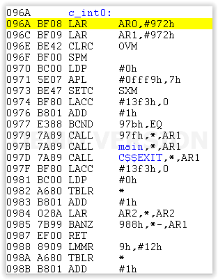

  • Ok, consider this. Below is the C code of the c_int0 function as defined in the library (RTS50.lib) provided with CC:

    Now, once compiled using CC and the included debugger, we get the following machine code:
    Now, here's a screenshot of part of the firmware. The c_int0 function prbably starts at 0x801D, with both BF08 ???? BF09 ???? being the two LAR instructions of the c_int0 function, and the 7A89 being the CALL instructions.
    Here's a disassembled view of it (labels added by me)
    It may have some slight differences, but I'm persuaded the code at 0x801D to be a c_int0 function. It totally possible that the words prior to 0x801D are not part of it. I have no clue about their purpose.
  • While the stuff at 0x801d does look like code, and it does start with "lar ar0, #948" "lar ar1, #948", notice that the next instruction should be "CLRC OVM", but is "SPM 0". I think you've found a similar function, but not _c_int0.
