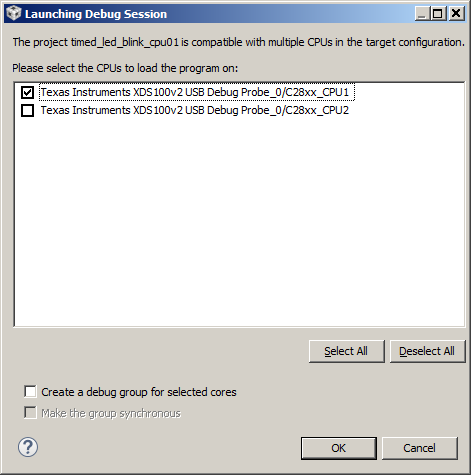

    Thank you so much for trying it out, which gives me more confidence to continue. However, I tried the same example from the latest controlSuite (v170), but still could not get it work. I set CPU1_FLASH active, build and loaded it into CPU1.  I saw LED3 (GPIO34) flashes rapidly even after power cycle the board. Then I followed the steps in the video carefully to modify the debug settings which involves two changes ( load symbols only & set to real time mode). But when I started the debugger again, it gave me error (see screenshot #1). This is for Blackhawk 560V2 emulator.
    Then I tried to use the on-board XDS100v2 emulator with the same steps. It also gave me error but a different one. It reported error connecting to the target at C28xx_CPU2, even I specifically connect it to CPU1. See screenshot #2.
    I also tried 3rd emulator Spectrum Digital XDS220 ISO, which gave me the same error as XDS100V2 about CPU2. For all 3 emulators, if I unselected real-time mode, everything would work fine, except that it will load and debug from beginning, instead of while it is running.
    What emulator did you use? How did you set emulator when you started a new project? I set it in Project Properties -> General -> Connetion, and select from the list. I also tried to create "Target Configuration" with an user-defined config to product a .ccxml file. It works well for regular debugging but not for run-time target as shown in the video. Please advise what and where I got it wrong. Thanks for your continued support!
  • I used the onboard XDS100v2 emulator. Did you make sure to select only CPU1 when prompted for which CPU to load the code into? The error in your screenshot seems to indicate it is trying to connect to CPU2 as well.
    This is the sequence of steps I followed, please give these a try:
    - Go into menu Run->Debug Configurations and delete the debug configuration for your project.
    - Set your project to use the target configuration file with the XDS100v2 debug probe
    - Select the project in the Project Explorer view and click the Green bug button
    - Since it is the first time starting up this debug configuration, CCS will prompt you to select the CPU to load the program into
    - De-select CPU2 so the code is loaded only to CPU1
    - Click OK. After code is loaded, run to verify that it is working and LED blinking as expected
    - Halt the code, terminate the debug session, power cycle the board (LED should be blinking after power cycle)
    - Go into Run->Debug Configurations, select the debug configuration for your project and set "load symbols only" and "enable real-time mode"
    - Click Apply and Debug.

    Thank you so much for the detailed steps. Yes I got the XDS100v2 working now for deleting the existing debug configuration file and start a new one. However when I follow the same procedure step by step for the Blackhawk XDS560v2 (my main emulator), it still gives me "Power Failure on Target CPU", as shown below. It actually loaded the code into flash and the code runs fine, so I assume that my XDS560v2 emulator is ok. I have latest CCS 6.1.1, and I'll update emulator to the latest to see if it will makes a difference. In the meantime please let me know if you have any other suggestions to troubleshooting XDS560.
  • Hi AartiG,
    Just want to let you know that I updated the emulation package to the latest. Now my 560v2 emulator also works. Thanks so much for your help. I almost gave up until your post. I'll label this thread as answered for now. Hope to see you again later in this forum!
