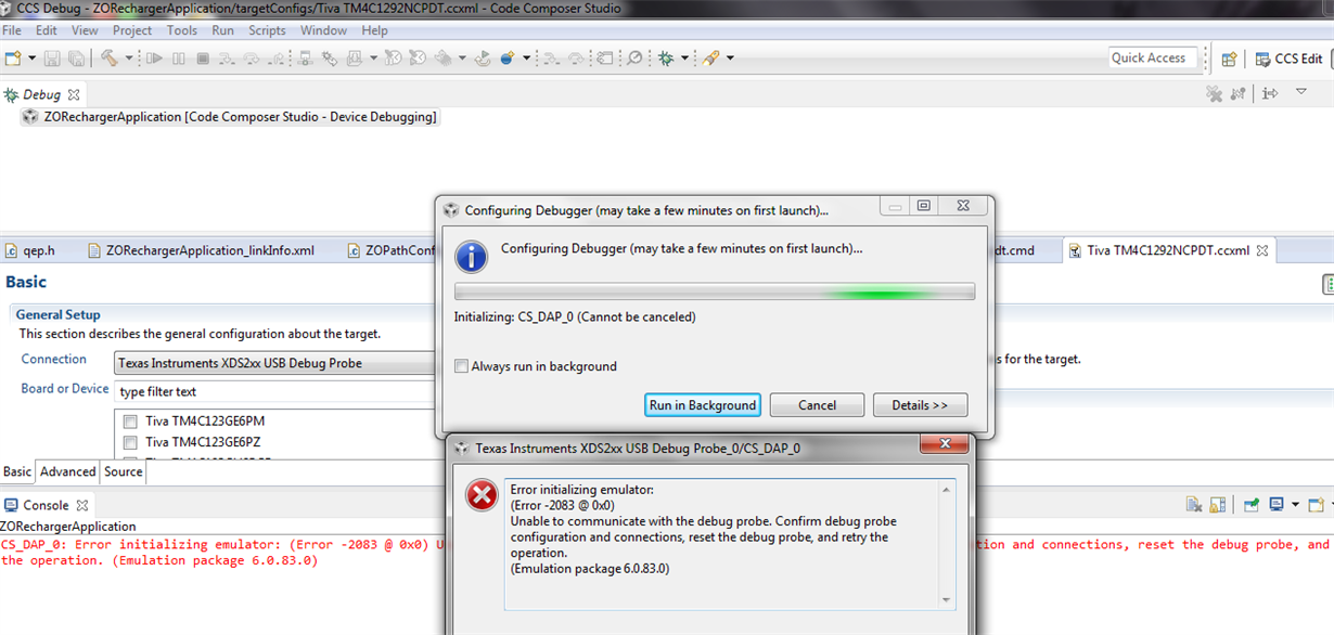

I was able to successfully connect, flash and debug the software using XDS-200 debugger all these days.
All of a sudden from this morning am getting the following error:
Configuration: tm4c1292ncpdt
Debugger: XDS200
Request your help to assess and fix this issue, is there any firmware upgrade needed? i have done multiple resets of the debugger by removing the power/connection from the laptop, but of no use.
-Nikhilesh
    Please take a look at the troubleshooting tips here:
    http://processors.wiki.ti.com/index.php/Debugging_JTAG_Connectivity_Problems#Host_connection_error
    Personally I hit this error as well a while ago when I was working with XDS200 and TM4C1294LP. The error was intermittent, but in some instances, it would get into a state where a simple disconnect/reconnect or power cycle of the emulator was not sufficient to clear the issue, instead a restart of the PC was required. I was also running an older version of the firmware at that time, so you may want to check that you are running the latest firmware (1.0.0.6). My setup got a lot more stable after updating the firmware.
    http://processors.wiki.ti.com/index.php/XDS200#Updating_the_XDS200_firmware
  • I restarted the laptop and upgraded the firmware package; the issue is resolved now.
    Thanks!
