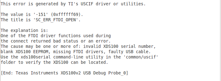

Use CCSv6, FTDI cable.
For a start, I decided to check 'test connection". That's result:
Same result with XDS100v2(3):
What i do wrong?
