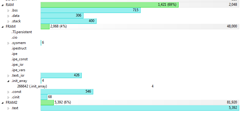

I'm using CCS v6.1.1. After building my application I access the Memory Allocation view to see its memory footprint. However, there is a discrepancy between the stated total summation of sections in FRAM and the total I get by manually adding the sizes.
In the image below, the stated total of FRAM is 2068 bytes; manually adding the subsections gives 1050 bytes. Anyone have an explanation?

    Can you attach the generated map file for the project?
    ki

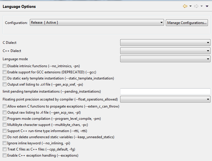

  • Unfortunately I cannot due to project restrictions. I realize this limits the help others can provide. I suspect that this is related to compiling for C++. We converted a couple existing modules originally written in C++ to C and the discrepancy was reduced. Are there any general compiler options to reduce the overhead of C++?
    Here is a copy of our Language options. Everything seems to suggest we are compiling for a minimal implementation of C++.
