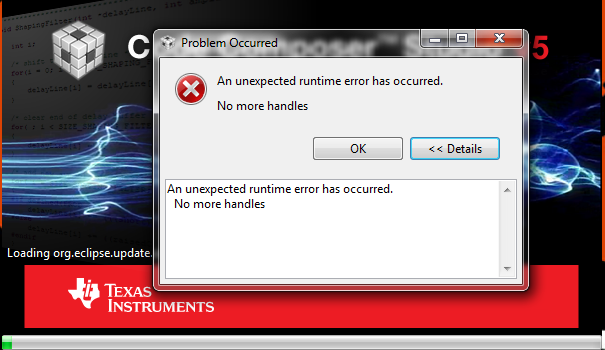

I have installed CCStudio v5 on my windows 7. The installation was successfully while opening up CCS.exe icon prompt me to default workspace and then I see  dialogue error message coming up. Problem Occured " An unexpected runtime error has occured".  It prompts me to open up \.metadata\log file and i see below error message in log file.

  • Hi Raj,
    The error you see can have several potential causes. One is conflict with other software running on your computer. Some known ones are programs that adds some buttons to window title bars (like displayfusion or teamviewer). Do you have any such programs installed?
    https://bugs.eclipse.org/bugs/show_bug.cgi?id=402983
    Another related issue was caused by a virus (removing the virus resolved the issue).
    If the neither turn out to be the cause, can you zip up the .metadata folder in your workspace and attach it to this thread?

  • Kelvin,
    Raj is hitting the error before he even gets a chance to start a debug session. He gets the error when trying to launch CCS. The trace/ds logs will only capture data related to a running debug session.
