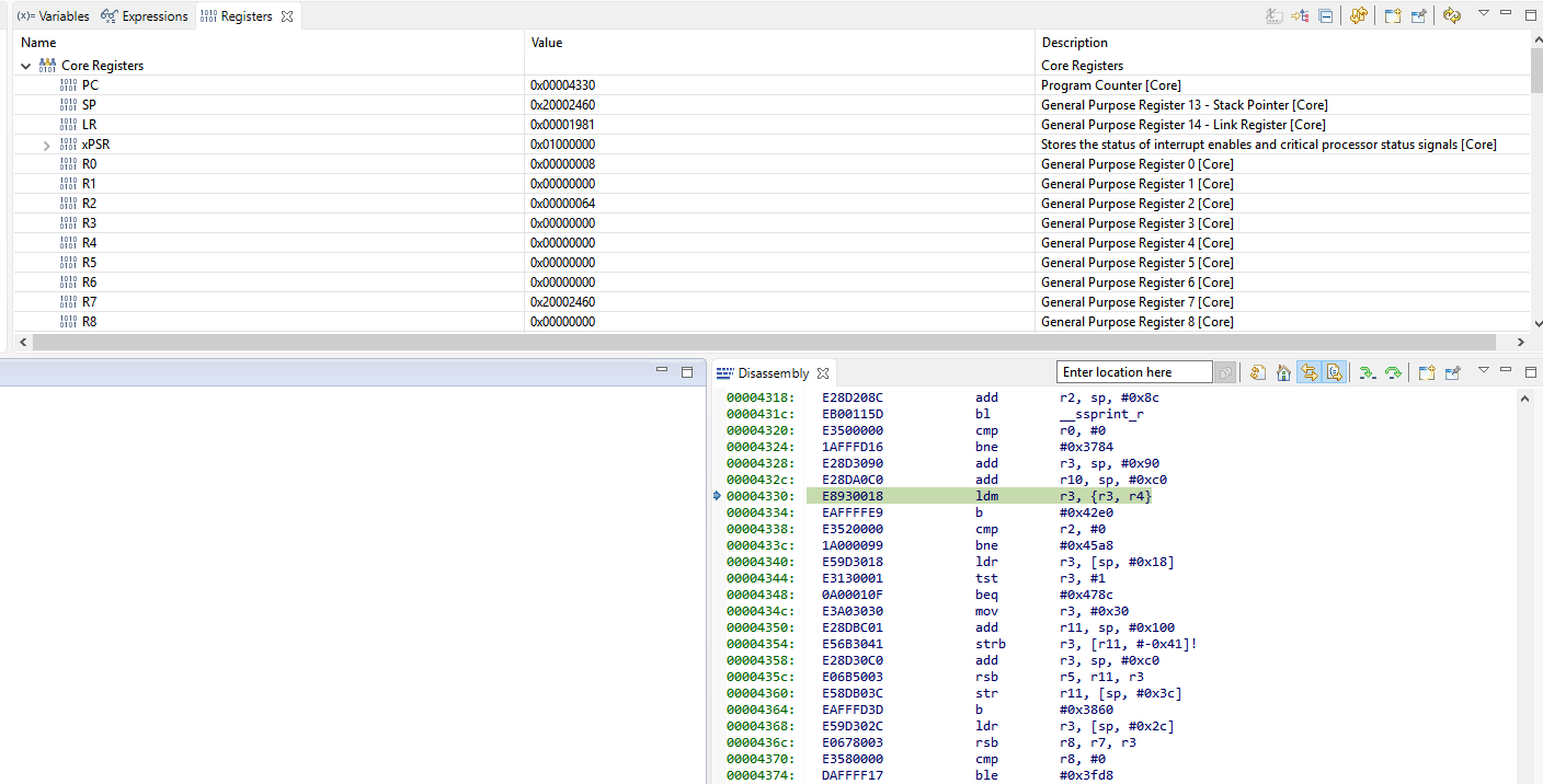

I have a program which is failing when initializing an array to zero, ie:
char data[100]={0};
This code using Linaro 4.8.3 calls the memset function which is creating a hard fault. I did set the stack pointer to the top of SRAM, and the program is very simple so stack should not be issue.
The NVIC_Fault_STAT has No Compressor Usage Fault Set.

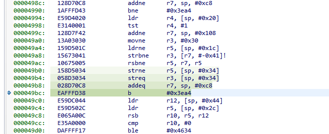

Below is the last instruction before the fault is set:
The code runs if compiled with the TI compiler, note I would use TI's compiler but at $750 for CCS I would just buy a chip from another vendor like Atmel.
I also tried the same code with Linaro 4.9.3 however it is getting stuck in the Default ISR Handler when executing code below, again in the memset.
    I am guessing you are using a Cortex-M4 (e.g. Tiva C series) device which only supports Thumb mode instructions.
    If you link a GCC library which uses ARM mode instructions the library function can trigger a hard fault.
    See Working with GCC libraries on how to select the correct GCC library for a Cortex-M4.

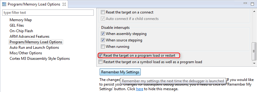

    I was able to run the code on a TM4C123GH6PM - basically, its initialization is somewhat different than MSP432, as it resets the target prior to a code load.
    In other words, for Tiva you can try enable the option shown below and see if it works.

  • I found the "reset target" box as well... That took a few hours... Seems like it would default to that when selecting GCC.
