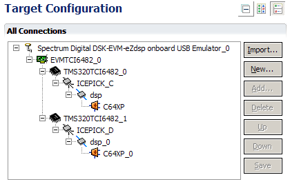

    In general, I'm interested in what happens after I hit the "Debug Active Project" button. That is, how does my executable get uploaded and placed on the target board via the JTAG interface? For instance I have the following target configuration:
    What "magic" is it that lets me interact with both TMS320 DSPs? I can upload different programs to the different DSPs, and I can inspect the different memory maps of each chip. I couldn't find any TI document yet that explains (in a detailed manner) how emulation works, especially with respect to JTAG and ICEPICK.

    For most devices we have a board or device file pre-created.  So that when you create a target configuration like you have in the capture the ICEPick values are all set.  If you click on the "dsp" in the screen capture it will show you the scan path port address of the device.
    In the configuration you have you are using the onboard emulator, i.e. a JTAG emulator that is built onto the EVM.  That will receive the commands from the debugger to read and write to the device.
