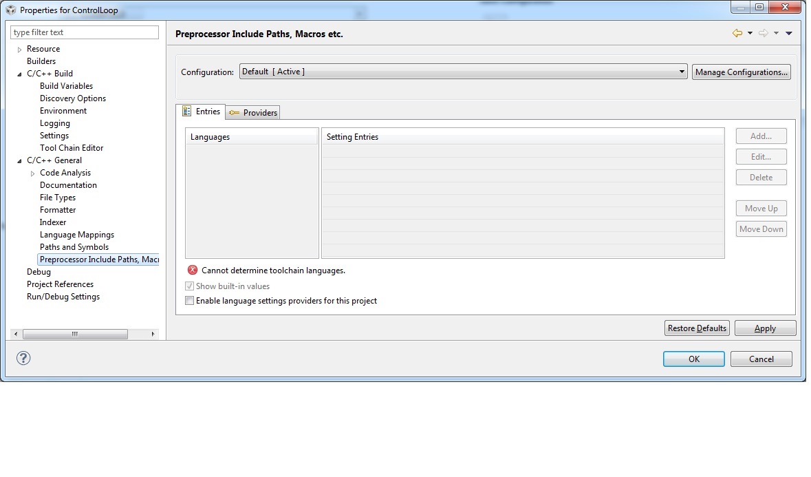

    Also if I try to "Open Declaration" it does not open the include file.I do not have Includes tab under Project Properties->C/C++ General->Paths and Symbols
    I noticed that the existence (or not) of the Includes tab depends on which build tools are selected during project creation. For example, for the TI build tools, I do not see the tab, but for Cross GCC or some other GCC toolchain, I do see it. So I suspect this may be dependent on the way your project was created.

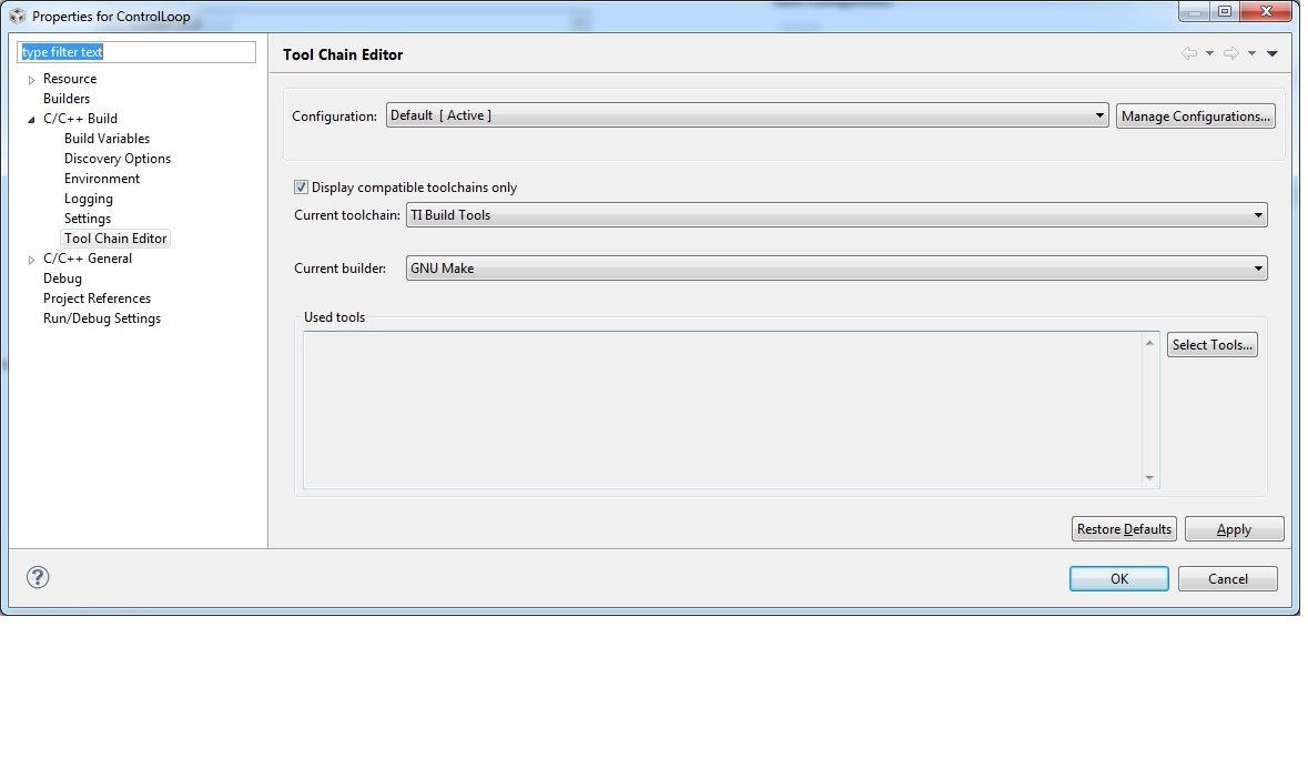

    If you go into Project Properties->C/C++ Build->Tool Chain Editor, what do you see there for "Current Toolchain"? With Toolchain as Cross GCC, I do see the Includes tab.
  • This is what I have.

  • If I select the toolchain as "TI Build Tools", I also do not see the Includes tab. But in that case, my assumption is that CCS already knows how to index the files, so it is not necessary to specify the include paths explicitly. I may be wrong though as I do not work with custom makefile projects much.
    You could try rebuilding the index to see if that helps.
    Also, since this is really an Eclipse feature and not CCS specific, you could try searching or posting to other Eclipse forums to see if others in the community who use Makefile projects have additional comments. Sorry for not having a better answer!
