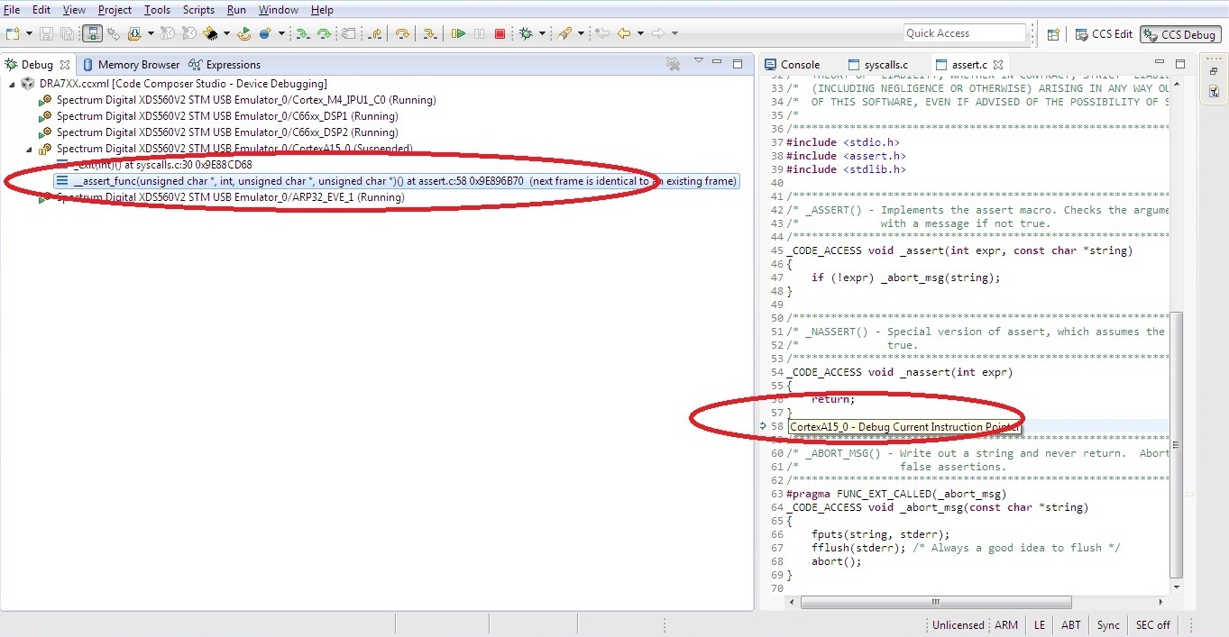

We are working in TDA2x Vayu Vision board with Vision SDK framework. We are using Code Composer Studio v6.0.0 for debugging purposes.
When we try to debug using CCS v6.0.0 in 7-inch display TDA2x board, the binaries(generated from Vision_sdk_02_07) are getting loaded for all the cores.
But when we try to run the cores,all cores are running whereas A15 cortex is entering into the suspended mode.
The same setup and binaries are working fine in 10 - inch TDA2x board. Is there any dependency on the version of sdk or board ?
Is the source lookup path mentioned below is correct ?
SOURCE LOOKUP PATH : D:\VSDK_02_07\ti_components\os_tools\bios_6_41_04_54\packages\gnu\targets\arm\rtsv7A\syscalls.c
SOURCE LOOKUP PATH : D:\VSDK_02_07\ti_components\cg_tools\windows\ti-cgt-arm_5.2.4\lib\src\assert.c

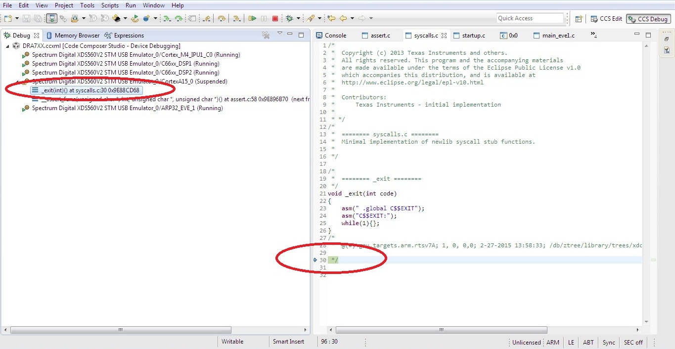

Atached the screenshot  of the error while it is entering into Suspended mode.
Kindly help us in solving this issue. Thanks in advance.

    I have cross checked again. The demo and even our algorithm is working fine in 7-inch board without CCS also. I tried connecting CCS again. But same problem persists.
    To brief about the issue again, I have a framework which has DSP1, EVE1 and DSP2. After loading binaries to all the cores in CCS, when I initially run A15, it is entering into running mode as expected. The same with DSP1 and DSP2 too. But when I tried to run the last core(EVE), EVE is entering into Running mode but then A15 is running into Suspended mode as explained in the previous queries.
