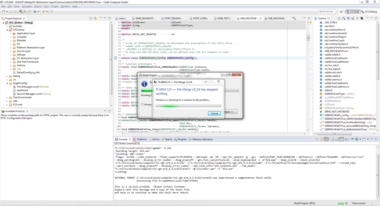

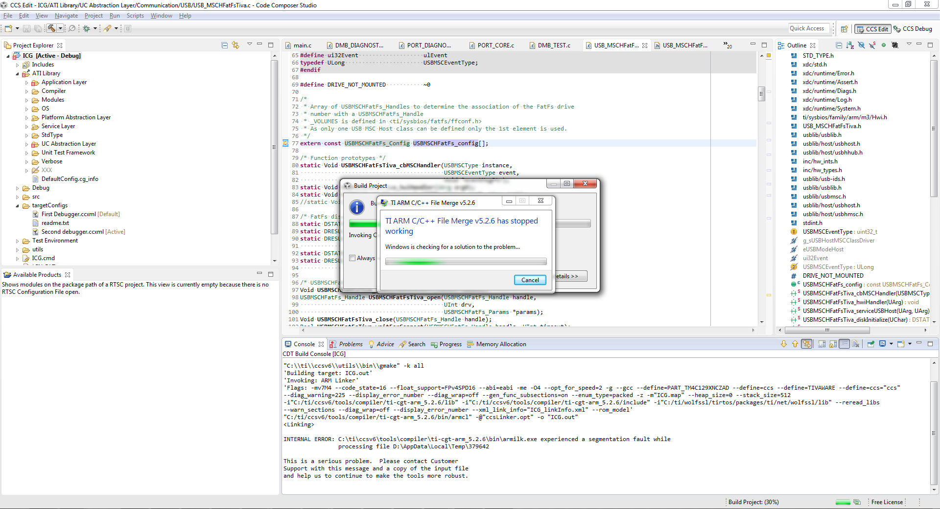

  • Actually, i tried to compile using "Whole Program Optimizations" option but something wrong went with the compiler, please check the attached picture.
  • thanks for the suggestion, but it won't help me as it will cause coupling between the modules.
  • That shouldn't happen.  Sorry.  To pursue this problem, we need a test case which allows us to reproduce it.  In this case, that means your whole project.  I'd appreciate if you would package it up and attach it to your next post.
