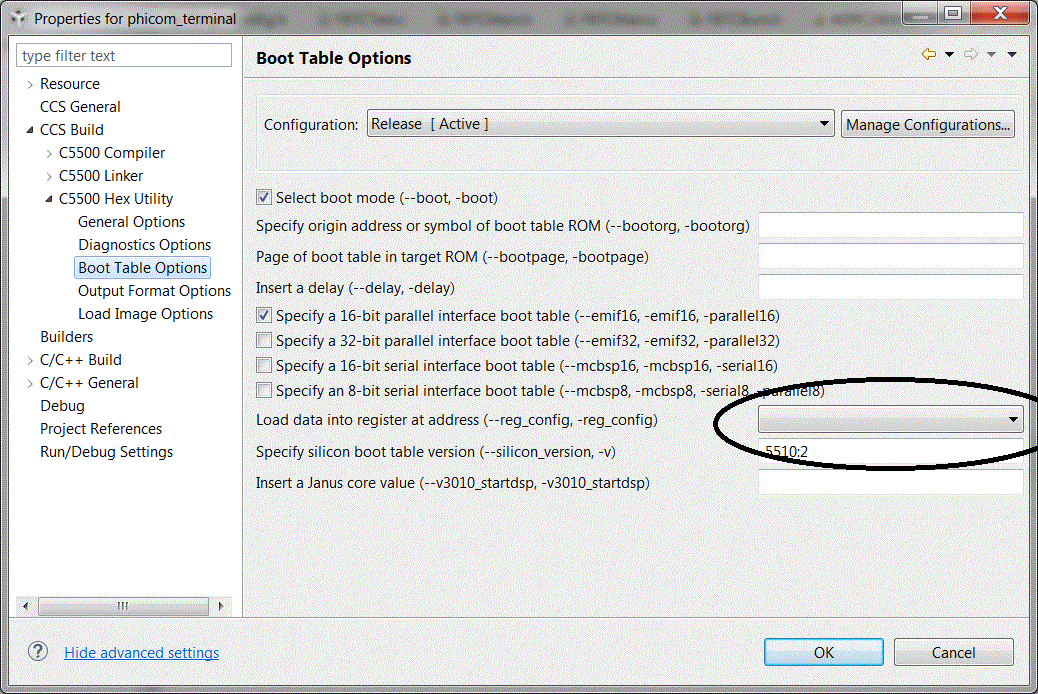

Using CCS6 and have new flash utility to program the hex file into my external flash - I would now like to add some configuration values to registers - such as
-delay 0xF00
-reg_config 0x3401, 0x0034 /* GPIO 2, 4 and 5 are set high */
-reg_config 0x1C80, 0x0000 /* Set PLL to bypas mode */
-reg_config 0x1C80, 0x0008 /* PLL put into reset mode */
-reg_config 0x1C88, 0x0008 /* PLL multiply set to 8 reference 10MHz F=80MHz */

to speed up the program load time on boot - this seemed to work with the old hex55 utility, but I cannot find a way to add the values in the new window for CCS6.
when I look at the pull down menu it appears a little vague as to how best use it.
    I agree that the drop-down options for --reg_config does not appear correct. I will file a bug report to have this looked into.
    In the meantime, you can pass these options via a command file. Add all the options you have listed above to a text file, and then you can pass the file to the hex utility as shown below. The path to the file can be an absolute or relative path. In the example below, hex.cmd is in the main project folder, but since the build directory is typically one level down (in the build configuration directory such as \Debug or \Release), the relative path to hex.cmd is one level up.
    Note that if you place hex.cmd in your project folder, then you will need to also right-click on the file in the Project Explorer view and "Exclude from build", otherwise the linker will try to link with that file.
    One other note: there should not be a space after the comma in the reg config option. Please see this related post.
    Bug tracking # for this is SDSCM00052622.
