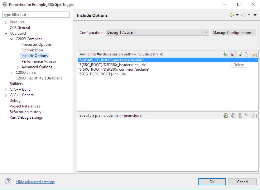

  • also 2 warnings pop up:
    Description: Build variable 'XDAIS_CG_ROOT' cannot be resolved. Resource :Blinking_LED
    Path:- Location: properties Type: Problems
    Description: Invalid project path: Include path not found (\packages\ti\xdais).
    Resource :Blinking_LED Path: - Location: pathentry Tyep: Path Entry Problem

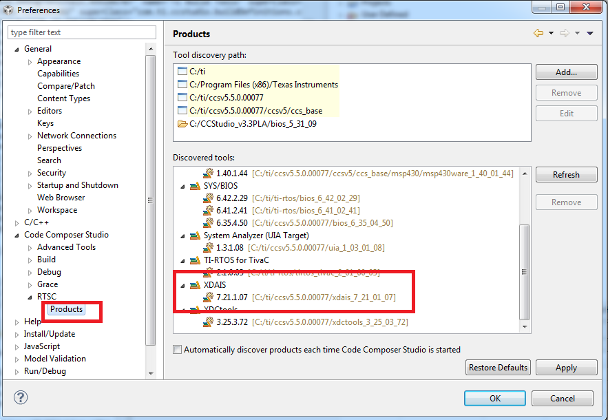

  • Do you have XDAIS in your CCSv5.5 installation? You can check in your workspace preferences:
  • No, the whole "Discoverd tools" section is empty....

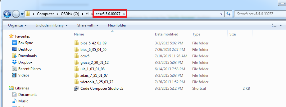

  • Note that I tend to install each CCS version in a dedicated version as shown below:
    Note that when I installed CCS, I chose to install everything so I have installations of XDAIS and XDCTOOLS also.

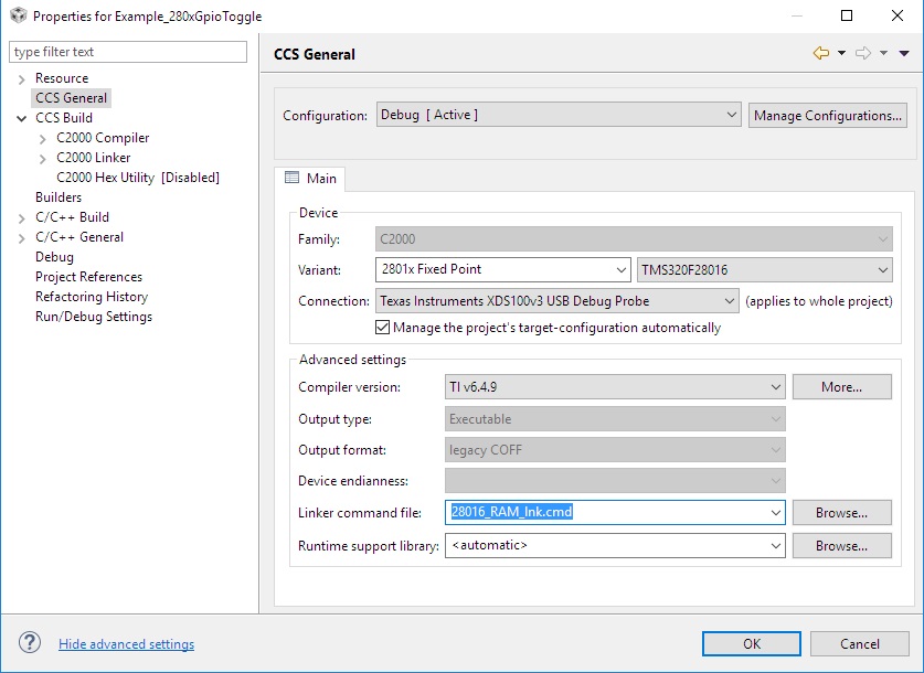

    8. Right-click over the top level of the project in the explorer (at the left side of the CCS GUI) and select "Properties". A new menu would appear. You need to edit several things here (all are very important if you have some errors remember to return here):
    8.1. in the "Variant" drop-down select "2801x Fixed Point"
    8.2. in the field next to "Variant" select "TMS320F28016"
    8.3. in the field "Connection" select "Texas Instruments XDS100v3 USB Debug Probe"
    8.4. in the field "Linker command file:" select "28016_RAM_lnk.cmd". This is very important step since the original "2808_eZdsp_RAM_lnk.cmd" of the project is not working properly with the newest compiler.
    Refer to picture to see the options set. After you are done click "OK".
    9. Right-click over "2808_eZdsp_RAM_lnk.cmd" and select "Exclude from Build" (you can also delete it). If you forget to do this you would have a lot of errors and warnings later since there would be two cmd files and duplicate memory definitions in the project.
    10. Right-click over the top level of the project in the explorer (at the left side of the CCS GUI) and select "Properties" again. Navigate to the sub-menu "C2000 Compiler" and click on "Include Options" delete the search path for "xdais" - refer to the picture below. Click "OK". This fixes two warnings related to the "xdais" library which is included in the project but not really used.
