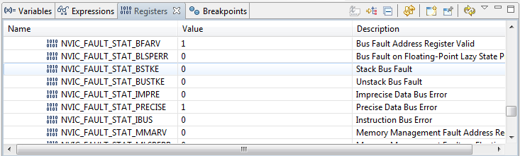

I'm using an TM4C1233H6PMI device, with a very simple code. Based on SPMA044A application report (spma044a.pdf) I protected a section of the code (from 0x800 to 0x1800 where the .text section is placed) as execute-only. Working with CodeComposer v5.5.0.00077.
I can run all the code, but when the code makes a call to a strtok() it generates a busfault. This behaviour is seen only with strtok(); i've tried with strcmp(), strcpy() and some driverlib functions and they all function properly, i mean, they don't trigger a BusFault.
Looking into the disassembly code, there is an LDR call pointing to a protected memory area (I put an breakpoint before the FlashProtectSet() call in order to see the disassembly, that's why is visible in the image).
Going deeper, the FaulStat shows a BusFault precise fault, and the FaultAddress is shown in
the image.
The disassembly at the Fault Address shows this:
As you can see, the LDR instruction points to $C$CON1.
Now the question is: how Can I fix this issue? I'm missing something here?

  • The problem is that the strtok function reads an embedded constant, but you have HW protections enabled which limit memory access to execution only.  An embedded constant is a constant value placed in memory right after the instructions for the function.  Unfortunately, these things do not work together.
    One solution is to disable the HW protection.  That's probably not what you want.
    The other solution is to build all of your code with the option  --embedded_constants=off.  Please read about that option in the ARM compiler manual.  This means everything, including all the libraries you use, should be built with --embedded_constants=off.

  • The ARM compiler release is supposed to ship with rtsv7M4_T_le_v4SPD16_xo_eabi.lib, which is the same as rtsv7M4_T_le_v4SPD16_eabi.lib rebuilt with --embedded_constants=off; you shouldn't need to rebuild it yourself, just change to that library.
  • Thanks Archaeologist, I changed the properties of the proyect selecting rtsv7M4_T_le_v4SPD16_xo_eabi.lib and rebuilding driverlib.lib with --embedded_constants=off and the proyect start running.
