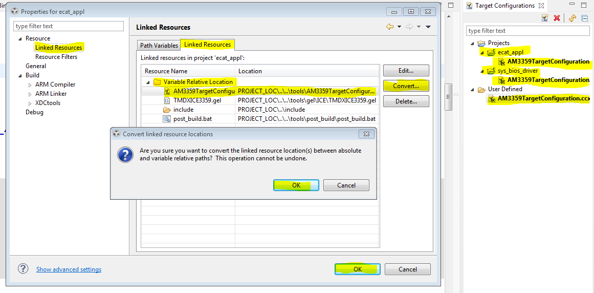

Correction:
I found out a way to do it using CCS to make the change for me. We can to go to the project(s) property, and add the path there. See image below:
