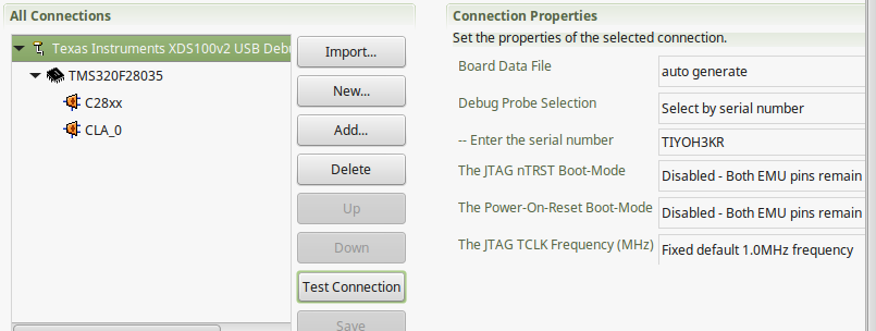

    This is my configuration in CCS
    This is what happens when I click on Test Connection

    The output of the xds100serial utility indicates it is a v1. What happens if you configure your .ccxml file to use a XDS100v1?
    Over the years slight changes to the XDS100 device drivers made v1 and v2 almost 100% compatible between them, but in my experience I have seen the ability to connect be impaired in certain scenarios. Perhaps that is what you are experiencing in this case.
