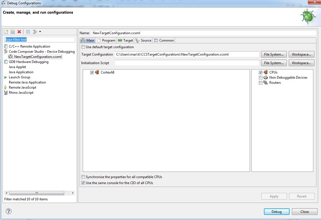

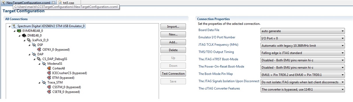

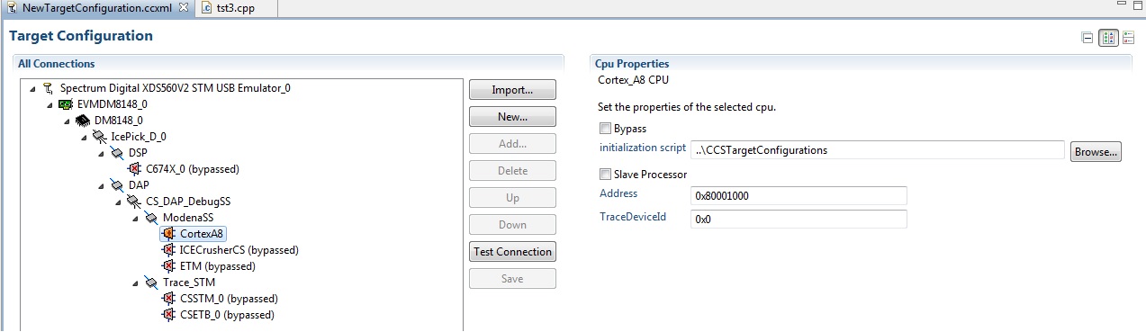

I try to debug via jtag simple "Hello world" app for linux but I'm getting error!
I use ccs 5.5 and TI Mistral board. I load linux from sd-card too.
My setting is:

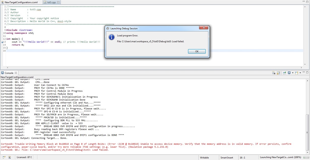

My full log is:

CortexA8: Trouble Writing Memory Block at 0x10818 on Page 0 of Length 0x14c: (Error -2130 @ 0x10818) Unable to access device memory. Verify that the memory address is in valid memory. If error persists, confirm configuration, power-cycle board, and/or try more reliable JTAG settings (e.g. lower TCLK). (Emulation package 5.1.232.0)
CortexA8: GEL: File: C:\Users\max\workspace_v5_5\tst3\Debug\tst3: Load failed.
