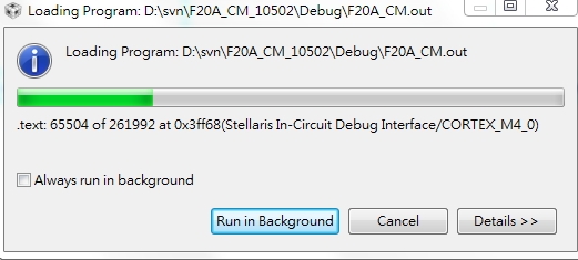

    Can you provide more details on how you are loading using CCS? Are you loading the .out file or loading .bin file from memory browser?
    Here is the loading image with CCS flow
    1.click  CCS Debug Button
    2.loading image to flash

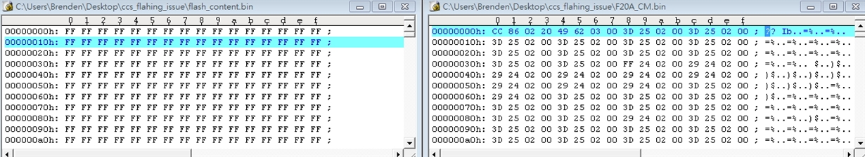

    1. I used LMflash programer to get the chip flash content as pic
    2. I compared both image with ultra edit . it do have a lot of difference .The significant  symptom is vector table was gone.
        attach .bin/.out/ flash_content.bin  and link file . ccs_flahing_issue.zip
