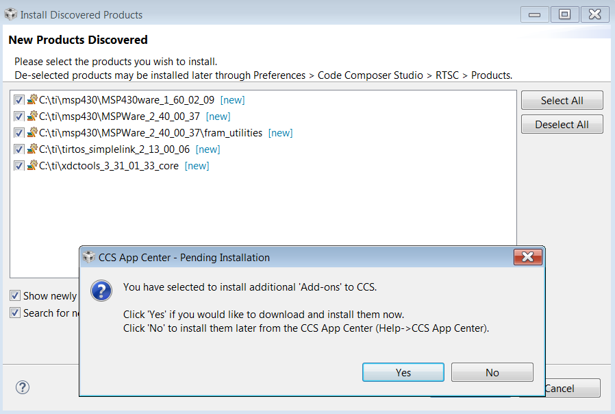

  • I have installed a new copy of the CCS software.  Launched CCSv6 and was prompted with this screen.  Last time I came to this screen, I decided to do the updates.  Should I do so now for this test?  The thing is, these software already exist on my computer under the same directories listed.
  • As far as I know it will make a totally separate install - but I have moved this post to the CCS forum in case they have other feedback.
    This is actually the method I use for customer support to be able to have multiple CCS sub-versions on my machine when needed. I think you need to change the folder at the top level to not be C:\ti. If you tell it to use C:\ti\ccsv6 you'll be colliding with your current install because that already has a folder called that. So better to change the "ti" folder to something else.
  • For the new products discovered, I would probably tell it no if you are trying to keep everything separate. It is actually saying that it went and found those already existing on your machine in a different directory I think. When I am trying to keep things 100% separate, I would tell this no, and then go to the App Center and have it install products from there (have it put them in your new base directory, whatever you call it, instead of C:\ti).
  • Sorry, how do I get to the "App Center"?
  • Look under View > CCS App Center. This will give you options to find and update additional components like MSPware, that you might want. I don't think these will affect you being able to program the Launchpad however, if you want to test if that is working first.

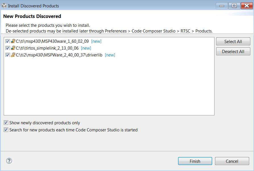

  • Ok, so the good news is:  Launchpad boards are working again.  I'm very happy about that!  Even more, the MSP-FET430UIF also appears to be working again with my own boards.  (I will however reply to the thread for that separately).
    That said,, I'm getting the following screen pop up.  But the App Center says that MSPWare is up-to-date???  I'm a bit worried that MSPWare_2_40_00_37 includes DLLs and drivers, so by installing those, I might just screw up my installation.  Since the installation appears to have been the problem, I really want to have a firm answer to this before proceeding.
  • Great! Wish I had thought of the fresh install sooner.
    Again, I would only add things discovered in C:\ti2 just to avoid confusion with your two installs, so just the 3rd item in the image above. When you start CCS you can uncheck the search for new products box if you want it to not come up like this for you every time.
    For MSPware (2.40.00.37 is the same version I have installed), this includes:
    -driverlib (this is not device tool drivers and has nothing to do with programmers, but rather is simply a library of APIs that you can use in your application code).
    -code examples for MSP devices
    -documentation/links for MSP devices
    -other code libraries for MSP devices that you may want to use (USB library, SMBUS library, touch libraries, etc)
    -If you want, in your file system before you make any selection in the above pop up, you could examine the release notes and manifest found at C:\ti2\msp430\MSPWare_2_40_00_37 in manifest.html and release_notes.html.
    You can use Launchpad without MSPware installed at all in fact - but MSPware has included examples for Launchpad.
    The "driver" type files for MSP430 launchpads and other emulators are found actually not in MSPware - rather they are already installed with your base MSP430 CCS. You can find some at
    C:\ti2\ccsv6\ccs_base\emulation\drivers\msp430
    and
    C:\ti2\ccsv6\ccs_base\DebugServer\drivers (here you'll see MSP430.dll for example)
    MSPware shouldn't have anything to do with emulation on MSP430 devices - it isn't even tied to adding support for new MSP430 devices - that stuff is all within the base CCS.
