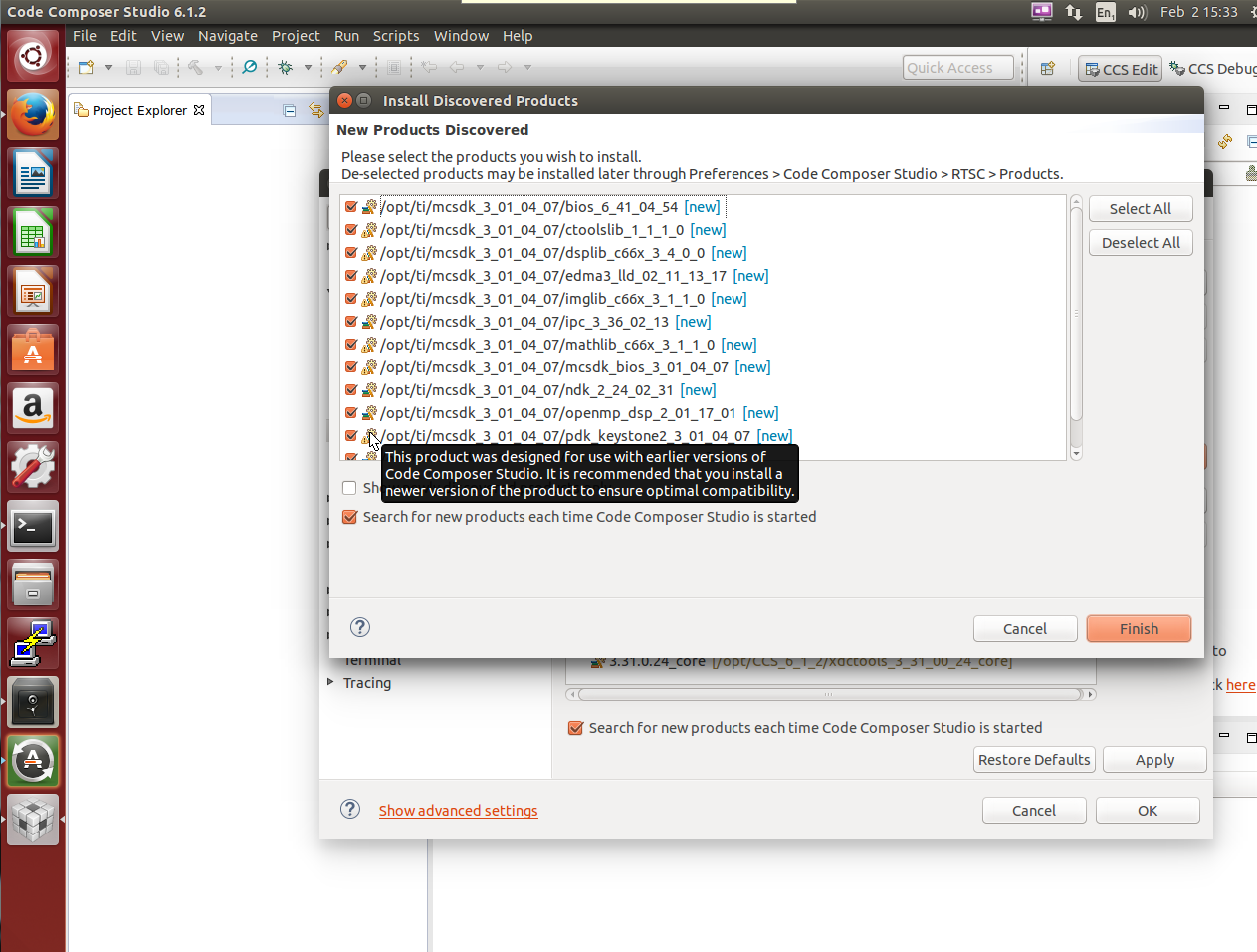

  • Shin,
    I can see that some of the products of MCSDK 3.1.4.7 seem to have been created for older releases of CCS. If you leave the mouse over a product with a small exclamation point, it shows the following:

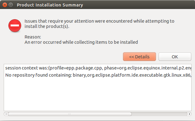

    Even still, I tried to install these components on my CCSv6.1.2, but it failed with an error message below.

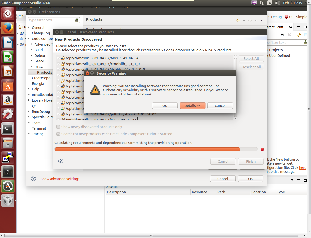

    However, since I installed my CCS as a superuser, I then ran CCS with the proper permissions and the installation completed successfully, only with a warning about unsigned components.
    I then double-checked the install, and it seems to have succeeded.
    Please try running CCS as sudo and see if it works for you.
