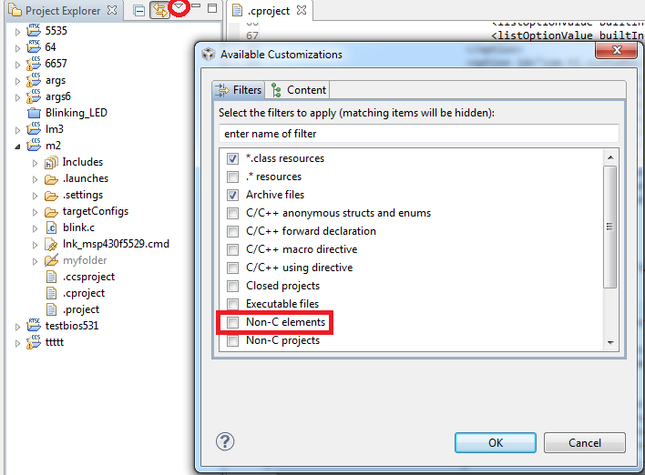

Hi Rich,
I wonder if you have a filter set that is filtering out the excluded folder. Can you go to the Customize View dialog for the Project Explorer (click on the little reverse triangle and select 'Customize View' in the drop-down menu) and see if "Non-C elements" is enabled in the list of filters?
ki
