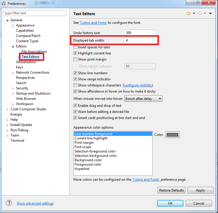

  • Hi David,
    The option for this at the global (workspace) level is under: Window -> Preferences
    As far as I know, you can only set this at the workspace level and not on a per file basis. So I'm a little confused why you only see a few files showing this behavior...
