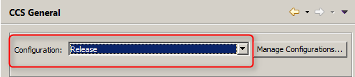

I have included paths for the directory which includes all the headers in the ccs6 project_build_properties\c_c++general\paths and symbols.
It is not able to locate the types.h and apparently rest of all headers.
