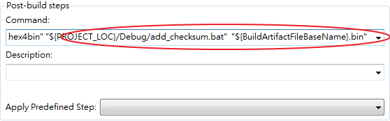

    Here is what i add in post-build text box

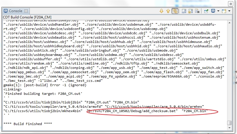

     Here is the message form the console :
It look like the .OUT file was generated successfully. but .bin file failed .
My questions are :
   1. Why my command were not present in a new line as above pic  ?
    2. How to write the post build-steps command to build image with bat (parameter needed )
