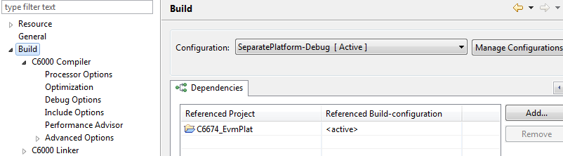

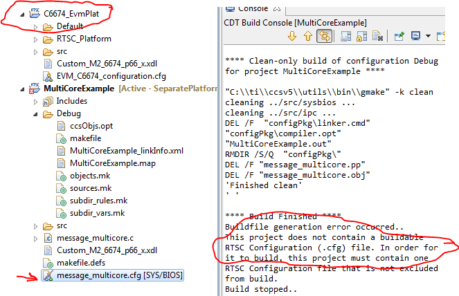

    Perhaps its because I'm using CCSv5, I was not able to find the "Resource Configurations", however, I was able to find the "exclude from build" which I selected for the .cfg shown below.
    From the instructions in your post above: "right-click on the file or folder in the Project Explorer view and go to Resource Configurations->Exclude from Build"
    I also added the separate platform (C6674_EvmPlat) to my projects build dependencies. See pic below.
    Unfortunately I get the error
    "Buildfile generation error occurred..
    This project does not contain a buildable RTSC Configuration (.cfg) file. In order for it to build, this project must contain one RTSC Configuration file that is not excluded from build."
    So its obvious I've successfully excluded the .cfg, but not the way that CCS likes me to.  :(
    Cheers
    Eddie

    ah yes... since the project is created as a RTSC project, it must have an associated *.cfg file. I don't think there is a way to workaround this. I'll check with the experts tomorrow to confirm (and I've made a reminder to myself to not forget)!
    ki
    I did confirm this today. And it is not possible to convert a RTSC project to a non-RTSC project. The cleanest (and safest solution) is to create a new non-RTSC project for your main one. Sorry for the inconvenience
