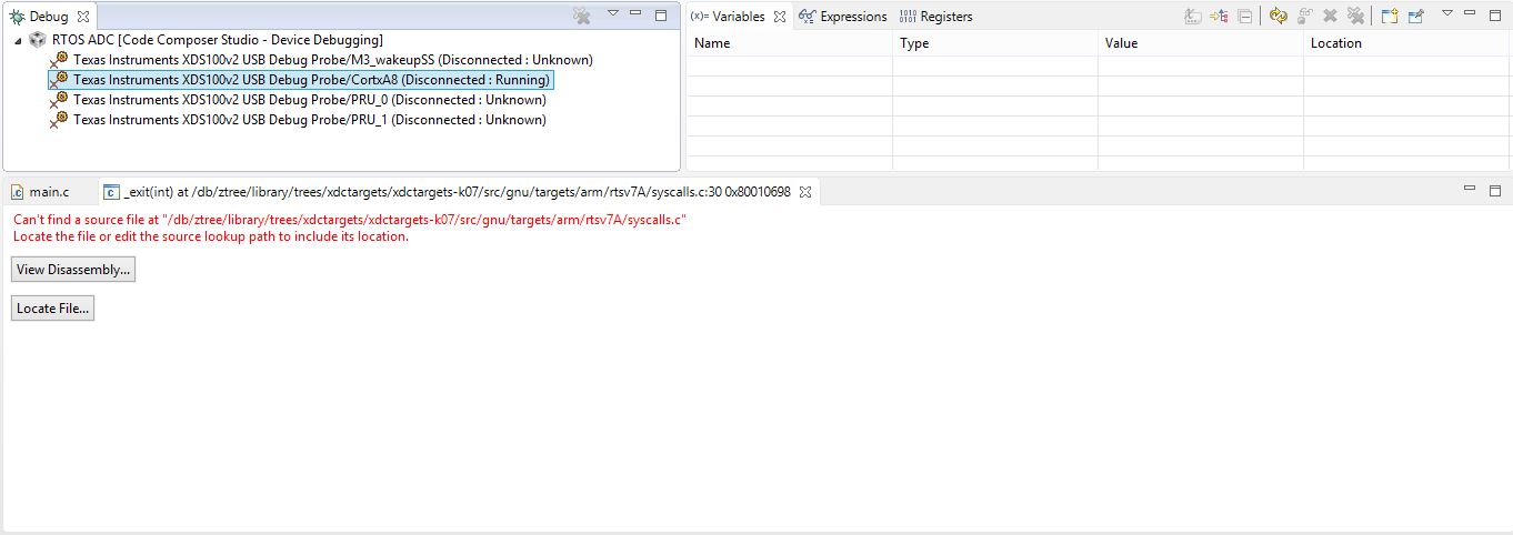

  • Hi AartiG ,
    Thanks for your quick response . I read in one of the post and figured out that the reference project and the main project have to be in the same location , so after making the required changes I could build it successfully. But now while debugging I am getting the following error ,which I have included in the following attachment below.
    Also below I attach the console log of my project.

  • Jijo,
    This last question might be best answered in the TI-RTOS forums. Please start a new post there and be sure to mention which target device you are working with.
