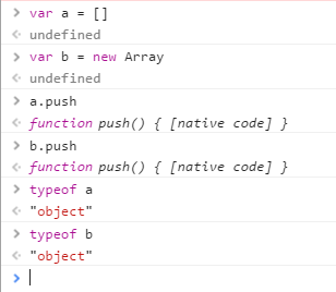

In Javascript, the following lines do not produce the same result!
var test1 = new Array(); var test2 = [];
The first produces an object with array functionality, while the second produces a variable of the type array. As such, the first one does not have common array methods such as .push() and .pop()
Hence, the code we both used will not run properly, as the array function lines do not run properly

Regarding test1 and test2, both test1 and test2 should have push and pop functions defined. You can try to open a chrome debugger and enter these two expressions and should be able to see both push and pop.
Here is the output from chrome:
