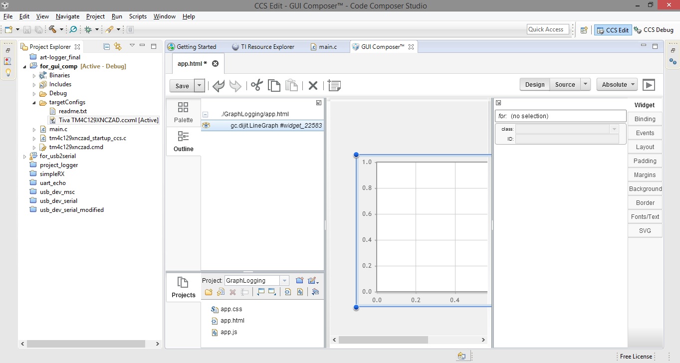

I am trying to implement a data logging example in GUI Composer I found in the TI wiki page. This example has a LineGraph widget that will plot the values of a table from a CCS project. When I select the LineGraph widget I dragged & dropped into the workspace area of GUI Composer, and select the Widget tab on the right to change the widget id, I can't do that because it says that there is (no selection). Below is a screenshot in order to understand better the situation. Why it does that?
    I don't see this issue and can't seem to reproduce it either. Which version of CCS are you using? Can you try creating a new GUI Composer project and see if it helps?

    I am using Code Composer Studio 6.1.2. I created a new GUI composer project but nothing new happens. Is there any chance that this problem is web browser related (because GUI composer is a web based app)?
