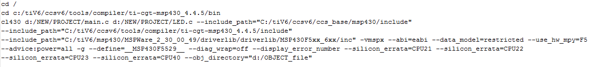

    So here I am trying to invoke the compiler using the compiler commands through command prompt.
     The compiler used : ti-cgt-msp430_4.4.5 (msp430 compiler)
    an example to compile two source files through command prompt is shown below :
    here it is seen that the command "cl430" is used invoke the compiler ,after which the source files must be specified that  need to be compiled, then the include paths are specified, and lastly the environment variables and the path to place the object file is specified.
    the entire command successfully compiles the sources files and we get the respective object files.
    Now suppose we have a number of source files to be compiled and many includes paths too, it would be cumbersome and the command length would be large. so, I want to write a separate text file which will have all the source files and a separate text file for the include paths and then call these two files in the command line.
    There is a command  " set MSP430_C_DIR "  which can set the variable "MSP430_C_DIR"  with all the include paths which are required to compile the source files.
    used as follows ;
     this is tried successfully .
    Similarly I tried to get all the source files to be stored in a variable and then use it with the cl430 command. but that wouldn't work ...
    Would like to know if there is any other way out ..?
    Thanks and Regards
  • The best solution is to use the option --cmd_file=name_of_text_file .  Read about it in the MSP430 compiler manual.  Once you understand it, I don't think you will continue to use MSP430_C_DIR.  But the manual also describes how to use that environment variable.

  • No, you cannot put the header file names on the command line or in a command file. You must include them from a C or C++ source file, or another header file.
    You can use as many compiler command files as you like; the contents of the command file are treated as extra options to the compiler.

  • hi,
    I have tried to read the contents of the text file, stored it in a variable and then used that variable in cl430.
    It works fine.
    Thank you so much for the help
