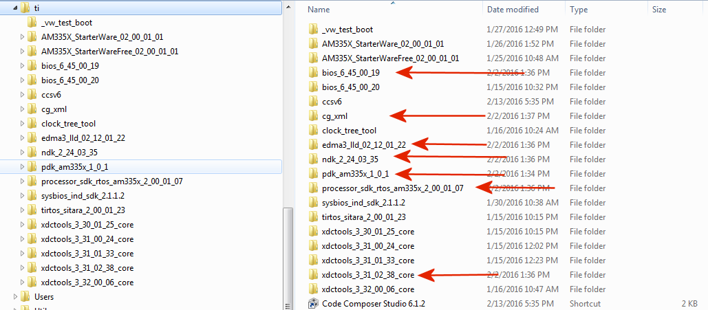

Yet the following is the directory tree showing they were installed.  The directories with the arrows were all directories (products) that came with the PDK.
If I re-run    ti-processor-sdk-rtos-am335x-evm-02.00.01.07-Windows-x86-Install.exe    it seems like it goes through the installation all over again.  Yet whether I re-run this .EXE or not, I still get the following in the Project Properties (note the red "X's" for the corresponding "not installed" products -- which were previously registered as installed -- I was working with the examples before the XDCTOOLS update).

    However, I did have PROCESSOR-SDK-RTOS-AM335X and PROCESSOR-SDK-RTOS-AM437X in a working CCS 6.1.1 installation under Linux, and when CCS was updated to CCS 6.1.2 (used the same directory and run the CCS 6.1.2 installer and pointed at the original installation) I had the same symptoms of CCS reporting that the PROCESSOR-SDK-RTOS-AM335X and PROCESSOR-SDK-RTOS-AM437X products were no longer installed when attempted to compile projects.
    I didn't keep detailed notes of how I fixed the problem, but I remember going to Help -> About Code Composer Studio -> Installation Details and and selecting to "Uninstall..." the PROCESSOR-SDK-RTOS-AM335X and PROCESSOR-SDK-RTOS-AM437X products before reinstalling them.

    My compliments on your tip!  That was worth GOLD!  I kept some notes on what I did.  I'm not out of the woods yet, but the above-listed problems were indeed solved.
    1.  CCS > Help > About Code Composer Studio > Installation Details.  I selected (one at a time, though it may be possible to do this in a group as well, not sure yet):  am335x PDK, NDK (IDE Client), NDK (Target Client), and EDMA3 and uninstalled them.  I answered YES to re-starte CCS between each one except for the two NDK items, which I did back to back and then accepted the re-start.
    2.  CCS > Window > Preferences > Code Composer Studio > RTSC > Products > Installed Products:  > [Install New...] button, and then I selected the already-existing directories for the above, namely:
       c:\ti\pdk_am335x_1_0_1
       c:\ti\ndk_2_24_03_35
       c:\ti\edma3_lld_02_12_01_22
    one at a time, re-starting CCS between each one.
    Now my Project Properties look like this:
    ...which is MUCH better.  Now I have another set of errors, but I'll take those up separately.  The problem I described above is certainly solved.
